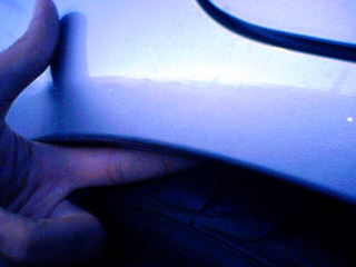

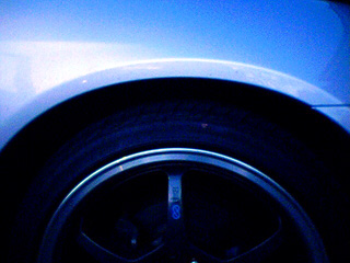

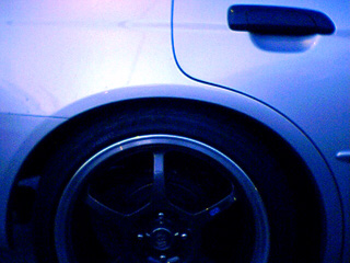

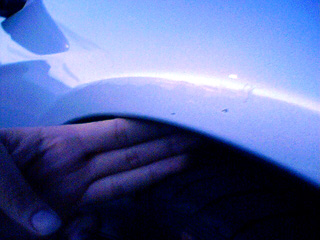

well i have tein s techs and the rear is sagging so much. the rear doesn't even have a one finger gap and the front has about a 2 1/2 finger gap!
can i do anything to fix this or help out? the more i look at it, the more i get upset. so someone please post something to make me feel better!
pics....fingers are tilted cuz rear can't even fit one finger straight. so its not THAT bad as it looks. take away about a 1/2 finger from front and back and that really how low..

Damn that's a big difference front to back. Maybe your shocks are blown

you think? damn, i was hoping they wouldn't blow yet cuz i wanted to save up and buy tein basics.

blown shocks dont affect ride height. Springs are what hold the car up, shocks just absorb shock from spring compression. Id try re-seating the springs, if not, i dunno what kind of warranty tein has, but i'd look into sending them back. How long have you had them?

most aftermarket springs are meant for coupes, as you have a sedan, that may be one of the issues.
second, it is possible that your rear struts are shot
third, a blown shock can lower your vehicle height unproperly because once the strut gives up, oil leaks out and has nothing inbetween the shock chambers. you also said "shocks just absorb shock from spring compression." it is possible that his tein springs are being compressed right now and keeping it that way.

It is not possible for a leaking strut to affect ride height unless there are two circumstances. #1 it orignially had VERY high pressure struts and they have leaked out all the pressure( not likely on our cars, have seen it heppen on some like toyota tacoma's). #2 the strut is SEVERLY blown and it is mechanically binding and holding the vehilce DOWN( this is VERY rare )
Most likely its just cause the springs are either poor quality or they have just flat out worn out!

Acutually a blown shock can cause sagging.... the stock shocks are a Gas charged Damper, The Charge in the damper is trying to Make that damper Extend, which helps sport the car a bit (its not its primary purpous, but it does any way) when the shocks blow, this charge leaks out, which can cause the car to sagg.
Considering you were on stock shocks... I'd have to say the sagging is mostlikely caused by blown shocks in the rear.

i have eibach prokit on my sedan with only an amp in the trunk and mine is one finger gap lower than the front. It's a common problem with sedans. Answer = full coils instead of springs so you adjust the ride height.
