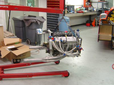

Depends on the Race Car! On our Crawford Daytona Prototype the suspension only moves around an 1" so it can be really low to the ground. CF Splitters get ate up all the time from rubbing the ground.

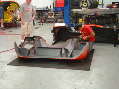

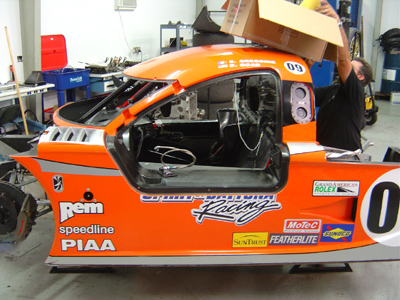

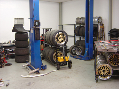

More Pics!

Boilermakers got it right. GT cars, specifically ones based on productioin cars need suspension travel. once you get in to Formula cars, such as the Daytona Prototype's shown above, you can design a suspension to work well with much less suspension travel.
