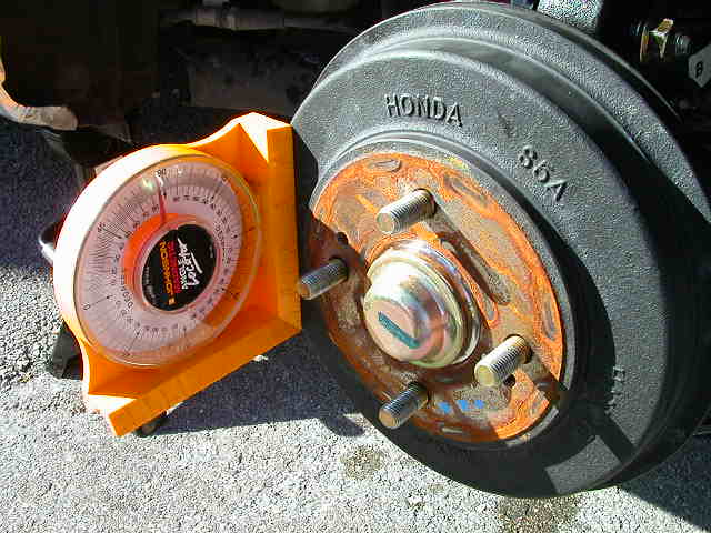

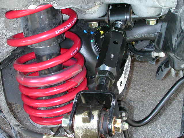

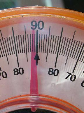

Ok, I think I finally got it more or less whitin 2 degrees. Looking through my Dad's electrical stuff, I found a tool that proved very useful. It's used for measuring angles on pipes, but it did the trick with the camber really well. At least that's how it looks at the end.
Measuring the distance from the center of the bolt that's closer to the drum to the center of the 2 bolts attached to the frame, I got 8.75 inches in length. Then, I added 1/16" on eah side of the arm, getting 0.125" in total length traveled. For the other tire, I simply repeated the process. Considering I had negative camber on both rear tires with Eiback Sportlines, this tool proved to be the closest I could get to the clearance I wanted. After I put the tire assy on, it looked just fine, at least until I get to the "performance shop" next week to put it within even better specs. Take a look:
This process wont be even remotely close unless the measurement and adjustment was made with the tire on the ground , not to mention i dont understand why people are so worried about thier camber and dont seem to care about the number one tire wearing factor TOE!
