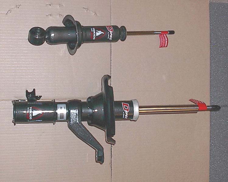

I got mine last week. Installed them Friday night. I already had the Eibach Pro-Kit's on factory shocks and it was really bouncy in a stiff sort of way. The D-Specs are set to full stiff at the moment and man are they tight. Funny thing is that they don't jiggle your guts they way the stockers do. It's like driving a whole different car. Way more solid. No more bobble around high speed corners. These were expensive ($540 from jdmwerks on ebay), but well worth it. I like driving my car again.

Can you get pics? They are adjustable, correct?

Pgnorris, could you post some pics of the D-Specs ? Are they supposedly the illuminas for the 7th gens ? Are the fronts complete replacements of the stock shocks ?

Here you go (see attachment). These are an exact fit replacement with all brackets. OEM quality fit. I put in some more miles today and learned that full hard is too hard for anything but the track. I actually think the car may break apart at the seams on bigger bumps at speed. I'm going to soften it 3 turns and see how it goes tomorrow.
Another thing noted is that between the new struts and an alignment with the front camber at -1 degree on each side (was at -.3 before), the car doesn't pull me all over the road at all any more.
The ride height is the same as the stockers with the Pro-Kits. The Pro-Kits settled in at a little over 1.5 inches lower than stock. More than advertised. Still, didn't need a camber kit. Some negative is good on this car. With 215/45-17 tires there is less than 1 finger gap.
Oh yeah. You WILL need a spring compressor for the rears. The shafts are shorter. I used a shovel handle against the rear a-arm for leverage. Like this: (./I) since I couldn't go get a spring compressor.
