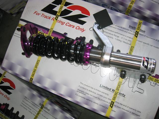

I ordered the Hayame coilovers over a month ago. They have been on back order for probably 6 weeks or so. Today I got an e-mail from the shop I ordered from saying that the Hayames will not be in for another 2-3 weeks. It continued to say that they are now offering anothe full coilover set up made by D2. I have never heard of this company. They are supposed to be popular in Asia and Europe and they have more adujustment options than the Hayames. They are $200 more. Has anyone heard anything of this company...good or bad?

From the picture you attached, it seems the D2 doesn't have the 3rd lock nut which is quite important in adjusting the spring load as well as damping stroke length retention. On the plus side, in the picture the D2 seems to come with a top camber plate. Also, the arm which facilitates the tie rod end mounting is very identical to stock which is similar to a Tein coilover design. This should reduce bumpsteer compared to the Hayame's which come as a straight piece going perpendicular from the strut. On the contrary, the Hayames will allow you to lower your car alot without much change in the tie rod angle. The D2 comes wth damping adjustability as well, but the Hayames do not. End of the day, it's about being satisfied with the choice of your suspension. Perhaps Vnilman or some other Hayame users can give you some advise here.

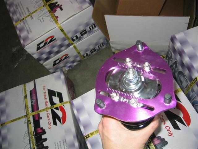

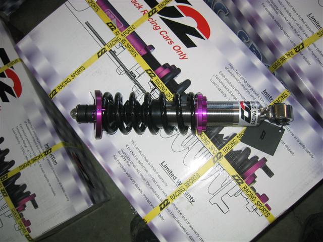

Here are the other two pics they sent...

those are hella nice. Id get those. that $200 more is for those camber/catser plates.

also I have to go along with Gary said. They only have 2 locking nuts, not 3 which makes adjusting the height/preload very difficult and probably time consuming to get it right. The base looks better made than the Hayames. They also have a camber plate, which will probably not be too useful since it changes the toe so severely.

it is not a caster plate, just camber.

I'm sorry, but those things just look so cheap. There's no beef to those things at all. I'm gonna go to the getting what you pay for argument... JIC, Tein, Buddy Club, Zeal, Apexi, Tanabe, and HKS dampers all cost what they do for a pretty good reason. A good set of camber plates is $400. A good set of race springs is about $300. A decient set of dampers (not awesome ones like Motons or Penskes), is at least $500-$1000. Do the math.

What do you mean "no beef"?
Spring rates are the same as Hayame. The D2 is also 36 way dampner adjustable.

Compare that casing to this....
JIC brackets and cases are at least double wall thick, triple in some places, the lower rear bushing is integrated right into the shock cup (which is 1/4" walled) rather than welded on like an afterthought, the front bracket is welded on, Jic wraps it around then seamwelds the whole thing, the second layer of the the bracket is then welded in from the other side, so the lower front bracket actually goes all the way around. All the bracketing on those looks like crap. It looks wimpy and looks pretty easy to bust off. The only thing that looks decient is the steering arm, which looks very robust, especially compared to the little stick that Hayame decided was good enough. Spring rates can be whatever they want them to be. That all comes down to how they're made, what kind of tolerance they're held to, and whether or not they're consistent enough to hold their length. 36 way dampers? Who needs that. No one is adjusting them between 36 settings, thats overkill and advertising bling. You can't sell something for $750 or $800 with decient damper internals. These things got cheaped somewhere, there's no way to really deny that. I don't question the fact that the high end JDM **** is marked up, but when you get right down to it, you can't offer similar features for less than 1/2 the price and expect it to be the same quality. Tein Basics are the same price, you can look at what they offer on them, I consider them to be a quality item. Tein has a reputation of making good stuff, and Basic is as run of the mill as they get. These are offering the same price, but nearly twice the features. Some people I guess think its a good deal, but I smell fish. Something gets skimped. Even Ground Control camber plates are 300 some odd dollars, thats half the price of these things. I'm not going to start a war here. I'm gonna be done now, I've justified my reasons. All I'm saying is those things do not look all that strong.

I still don't get your point. You think they are going to snap in half or something? I don't see how the JIC bracketing looks much different. We did a buy-in to become the US distributor, we are trying to move our inventory. Think about it..... how much do you think it actually costs to manufacture a camber plate. Do you think Ground Control can afford to do as much advertising as they do without a huge markup? Why do Ground Control camber plates cost $300? BECAUSE PEOPLE WILL PAY THAT MUCH.
The truth is you are basing your opinion on a few snap-shots, there is no way you can judge the product from that. Why don't you let someone try out the product before you put it down?
Well then why don't you provide something more than a few snapshots to go by. These things wouldn't go to market untested. Someone's got dyno data or track time on these things unless they're somehow exempt from all governing bodies. Either that or no R&D went into them.
Most people like more than pictures when buying something that their life in a car depends on. Track records or a reputation for building good stuff and standing behind it is typically helpful when people are trying to buy suspension parts. Thats why people continue to buy (and pay for) Konis, Hypercoils, Eibachs, H&Rs, JICs, Teins, Buddy Clubs etc....
So prove they're the real deal. Put em on someone's car then beat the hell out of them. Make your own track record if you have to. Show that they won't break down in a few months and they can take a street and track pounding. Because thats what we're all looking for... something that can take the punishment and something that will hold its specs (they dont sag or pop or worse). And if they work, so be it, someone's getting a real good deal.

So then they are fairly soft sprung, like the Tein SS. So this is a Street suspension then.
also, What is the % change in Damping from the 0 setting to 36? as in How much stiffer is the 36th setting Vs the 1st setting? also, wich setting are you changing, Bump, rebound, Both???

and the weld on the front JIC looks like *** compared to the D2.
