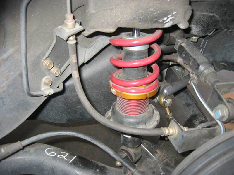

--- here's my car with stock struts and ground controls ---
this is the rear of the car, the next following steps will be for the rear assembly install only

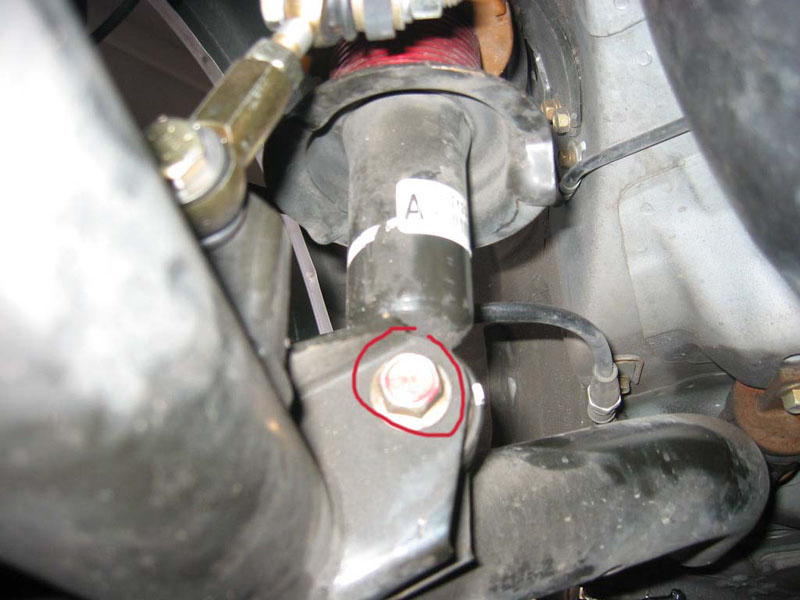

--- Next is the shot of the first bolt that I loosened ---
this one was pretty hard for me to get off...after you unscrew it for a while, you notice it stops comming out, so then you pull on the bolt, and it should come out. If it jammed like mine did, you have to swirve it around and try to wedge it out.

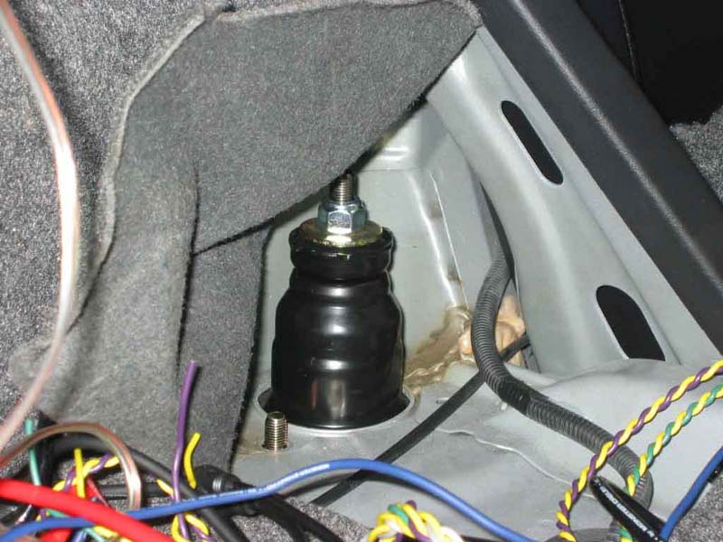

Ok, now you go into your trunk, scoot your rear seats in, and pull up the corner carpeting to expose the strut mounting points. Unbolt the 2 bolts with a 14 mm deep socket with wrench, these were a b*tch for me when i didn't have the deep socket head, the shallow one won't work cause the bolt is too long for it

after you unbolt those, go back out under the car, and push the stock strut out and wedge the whole assembly off, and wedge the hayame assembly in the stock position. I pretuned the hayame's before I put them in so they would all be at the same height. you can do it for what ever ride heigt you like.

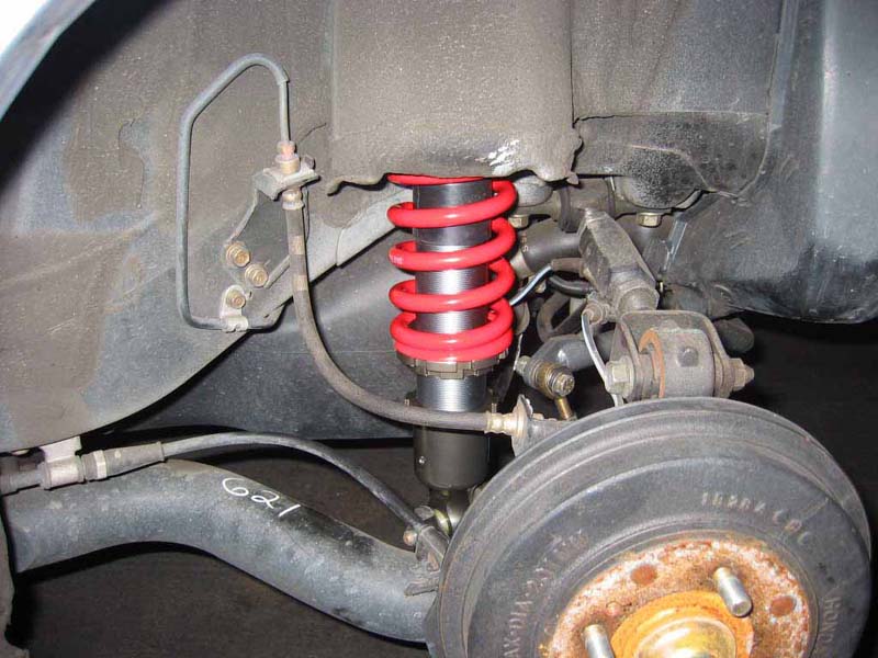

TO finish it off, use the lugs provided by hayame to secure the 2 in-car mounting points, and then put the BIG bolt back through the bottom end of the strut connected to chassy
Here's a pic of the finished product

and another

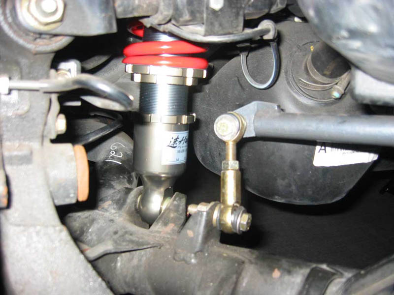

did you put that 3rd locking ring to work after?
Old Jan 23, 2004
chocobo15_2000's Avatar
§C§H§O§C§O§B§O
Posts: 1,808
From: San Diego
chocobo15_2000 is an unknown quantity at this point
yes i did...it adjusts the length of the strut like vinlilman said, instead of compressing the spring. Works wonders!!
