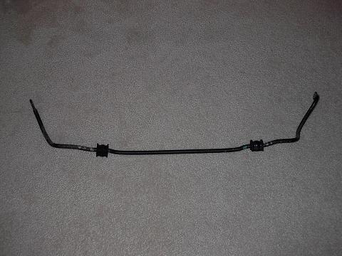

HOWEVER,
2002 HONDA CIVIC HX has a 12 mm oem sway bar
here's a picture of mine
Name:	oem civic rear sway bar.jpg
