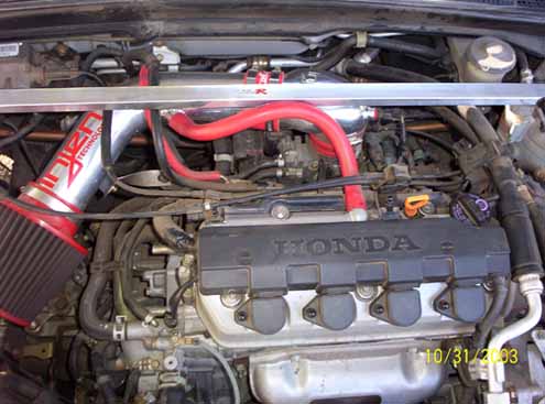

I just installed my Ebay Type-R front & rear strut bars!! They were really easy to install, it only took me about a half hour!!! Afterwards I went out to my favorite windy road, to try them out!! Holy $hit!!!! I could feel the difference as soon as I took off from my driveway!! Then when I went through the turns I could really tell the diff.!!!! I took those turns faster then I ever have before!!!! I Recomend these to everybody!!! A++++++

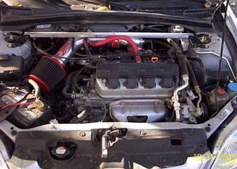

another

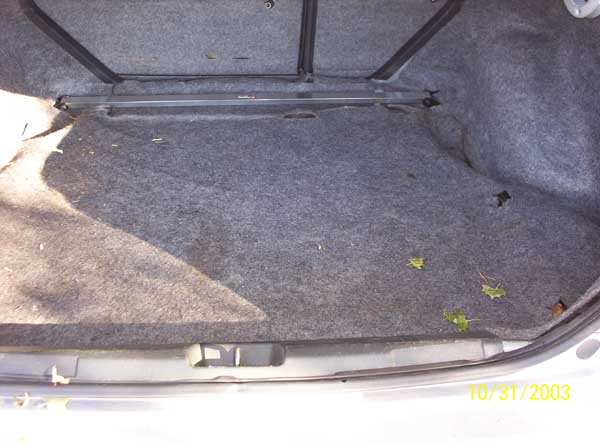

last one

My rear one took like a half hour to put on. You have to peel the carpet back, which took the longest amount of time.

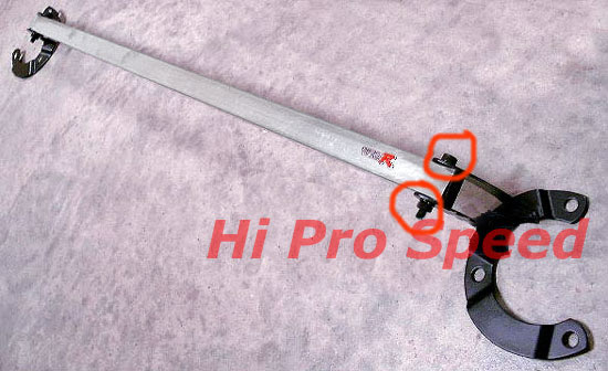

Here's I'll show you a pic of what my ends look like:
Ok wtf, the only ones I can find on eBay right now are the type-R ones like you have. Too bad I'm not still in the market for one.
edit: I just found the one I have:
And here's yours:
Your ends look much sturdier.
Ok I have a question. On mine you can twist the bar itself because the ends are connected by a threaded screw-type thing which lets you adjust the distance between the ends. Does yours work like that or is your a true one piece design?
Also, how wide is your bar? Mine looks kind of skinny in that pic but it's about an inch wide in real life, and maybe 1/3" thick. It's a rounded rectangle.

yeah I can see that yours dont look to sturdy! Yes mine is a true one piece! you just line up the holes and put the bolt through. Its the rectangle design and it is about 1" wide and about 1/2" thick.

If yours is one piece, what are these things that I circled?

i think I misunderstood your question. those bolts are were it hooks on to the mounts. so techincaly it is a 3 piece.

The front one goes over the strut towers. I'll post two pics after this paragraph of it. If you open your hood you'll see where it goes. Just take the nuts off and then put the bar on and then put the nuts back on and tighten them. You might have to jack up the driver's side to get it to fit. It will be self explanitory when you get it. I think you torque the bolts down to 33lb/ft but I'm not sure. Look it up here, someone has posted it before.
This pic is kinda blurry:
Here's the type-R one (same pic from first post)
The rear one is the same, except you have to pull back some of the lining in the trunk to find where it goes. It helps if you put your back seats down and work from back in there, too. Good luck.
