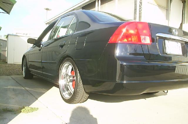

I didn't know Neuspeed Race were no sag guarantee... I didn't read anything about that, but mine don't sag anyway. The ride is equivilant to stock, unless you get 205/40/17 wheels and tres like me (bad ride). I love my Sports though, almost 1.5yrs and still on stock shocks *knock on wood*

I guess it would improve more than 205/40/17 because of a slightlyl taller sidewall, but then I don't think by much. The best ride you'll ever get is back on stock wheels. My next set of tires are going to be 205/45/17, whenever that will be... 215/45 is just too dang fat for our cars...
