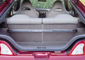

can't wait till neuspeed comes out wit rear upper

I thought the Neuspeed rear upper tie bar is out...
for the RSX:
http://www.neuspeed.com/products/pro...ils.asp?app=37|RS&type=12&ltype=ns_import&p_id=1032
it should fit ours.
just gotta drill holes, maybe.
same goes for the mugen one...

i'm scared it won't fit our cars
man....NEUSPEED WEBSITE IS OVERPRICED LIKE A ****!!!

i need the Neuspeed Rear Upper Strut Bar
and a Neuspeed Front Sway Bar
and my set up is complete all totaling to approx. $1000
