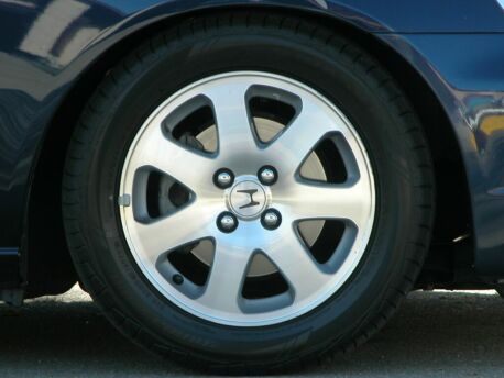

Here's a pic of how low GCs will go in the front on a coupe with the perch uncut. I have plenty of room in the rear to go lower.

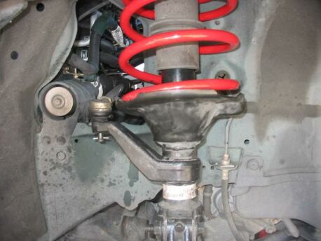

And just for those who also want to know WTF I'm talking about and don't know...
Before...

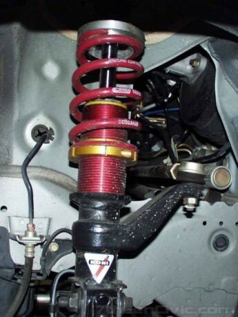

After - and yeah, you can't use springs again after doing this, sooo...

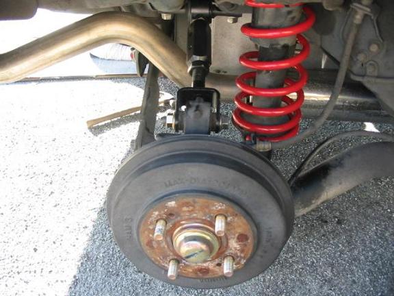

zell the rear doesnt have to be cut, but u were probably going to use a grinder and hacksaw to cut the lower spring perch
