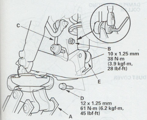

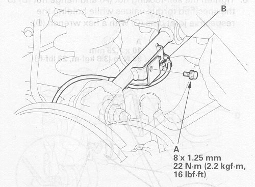

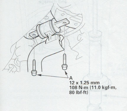

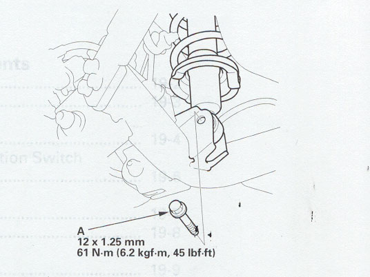

Anyways, I got some pics for you :-) got my helms today, hope this helps.
thanks for the encouragement, sometimes those RSX people get me going, I like the 7thgen boards significantly better than the RSX one... We learned in German class tonight that the germans I guess are big on where they come from, i.e. hometown etc... so "Ich wohne" (i live) or I am from means I was born there, they have a special word for if you choose to live somewhere else than where you were born, "wahl" from the verb "wahlen" to choose or vote. Ich wohne in Ephatch, aber Ich wahl in 7thgen.

Hey Ocelaris -
Thanks for the pictures! Yeah, those are all of them. Its funny that you got your manual yesterday, so did I! I looked up the torque specs for the bolts too - mine are a little different. It says that the front two bolts are torqued to 69 ft/lbs, vs the 80 which your manual says. All of the others are about 43-45 ft/lbs, which is right on the money where I estimated. I just have to go back and check the torque on them, to make sure nothing is wrong....
