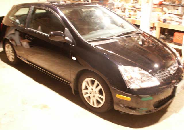

Just wanted to say how much I'm enjoying my coilovers, lowered to 2 finger gap all around. Rides great, took it out to the country today for a little spin Still need an alignment, but so far no squeaks or creaks.

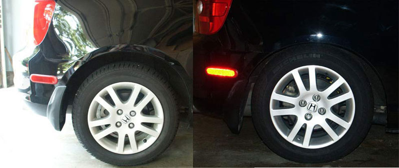

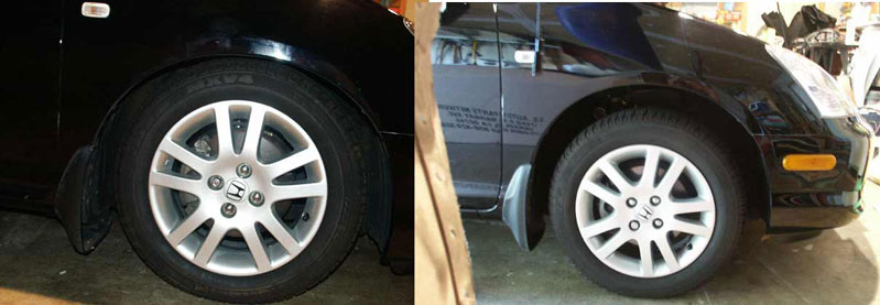

Thanks for the super speedy shipping of my rebate Glen, Can't say enough about my service from KW and HPA motorsports. I'm not normally a sticker kinda guy, but after my experience with KW, I'd be proud to don some big stickers on my car. Got a few pics for the rest of you all on my drop.
Old Jul 14, 2003
  #52
Ocelaris's Avatar
Posts: 209
From: NOVA
Ocelaris is an unknown quantity at this point
Sorry, if it wasn't obvious, one is before and after the coilovers... the bright one was in the morning when I started, and the dark one was at night after I finished... Ok, so it took me all day to complete, but it was my first time doing it, and I was workin alone, so it took quite a while, but It was all worth it.
