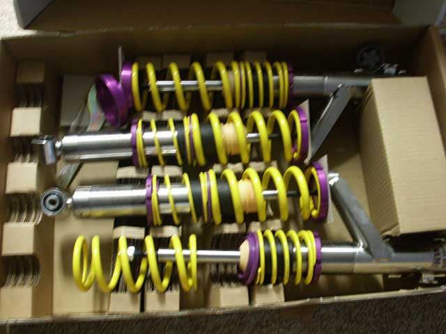

duh duh duh... stayin home to do a little install today

sexcivic2k1's Avatar
Posts: 2,760
they look bad(colorwise), i bet their hot though

I ordered mine quite a bit before you I think, and was supposed to get mine last week monday, so they rush shipped me some from germany, so mine didn't come with the regular KW shipment for ephatch's groupbuy... so I would expect yours before this weekend like glenn said, now that they have them coming in from germany I bet they'll be quick getting them to you.
sexcivic2k1, they're bright yellow and purple, the KW colors, and stainless steel colored, that was a quick pick I snapped when I just opened the box, not great lighting... I'll be taking some more pics throughout the day if I remember. Ocelaris

those are very nice!!! i'm excited to get mine!!! post more pics!!!

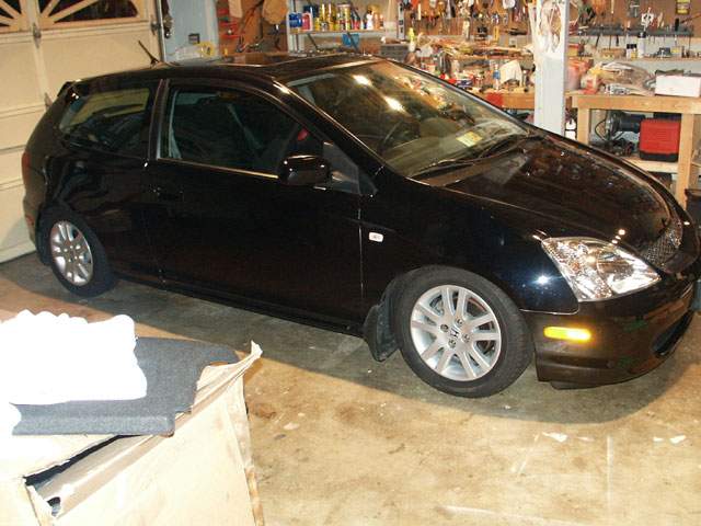

got my KWs installed! hooray, just have to adjust front camber a little, but so far so good

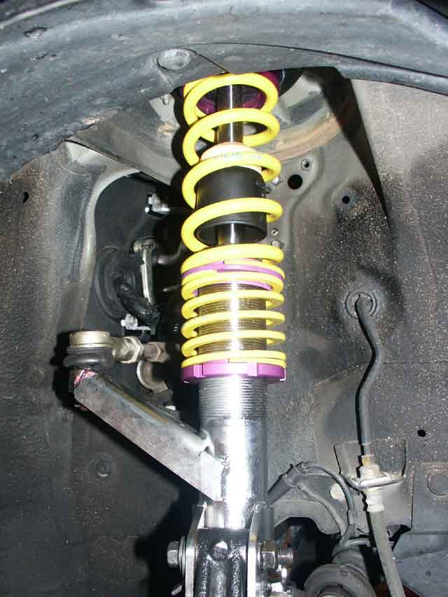

here's a pic of the front strut

that looks so low!!! how many inches did you drop it? hows the ride? have you test drive it? tell me..........waaaaaaaaaaaaaaaa
Old Jul 11, 2003
Ocelaris's Avatar
Posts: 209
From: NOVA
Ocelaris is an unknown quantity at this point
I dropped the spring perch in front 1.5" from the bottom, in the back 1" from the bottom (of the threads). I have 1 finger in the back, and 1/2 finger in the front.
Haven't driven it much, maybe 15 minutes, but it drives fine with the exception of the killer front understeer from bad camber... I managed to get the back set pretty straight, but the front is a little more complicated, and wanted to drive her as soon as her wheels touched the ground So far so good, no scraping, but I won't be able to do alot of driving until tonight, probably headed up to Rockville, MD if anyone goes there...
Ride is good, stiff, but I'm not quite please because i feel like I'm driving on rails... I'll adjust that after work.

what no dust cover over the shock?.. thats not good..
Old Jul 11, 2003
Ocelaris's Avatar
Posts: 209
From: NOVA
Where don't you see a dust cover? It's right below the bump stop.. the black thing, it just happens to be bumped up a little in the pic... I'll remember to move it back down, or I'm sure it'll get knocked down sooner or later when I hit a pot hole.
Definetly not as big a dust boot, but it's only needed to cover below the bump stop... remember stainless steel too...

BrotherSound's Avatar
Posts: 621
From: Largo, FL
BrotherSound is an unknown quantity at this point
stainless steel or not, you don't want to get sand or debris up there and get it scratched. compare it to the stock suspension or even my Tein's you don't see the shock pole at all. it keeps it completely concealed. besides i believe all shock poles are stainless or corrosion resistant.
see how the dust cover completely hides the pole on the fronts!.. (the rears use the stock dust cover so it hadn't been put on yet.)

hmm... curious, must be some reason for not having a dust boot... It said in the insructions to discard the stock one... Though for the record I consider the black part connecting to the bump stop a dust boot, and I'm betting the part that is covered that is important in keeping the shock lubed... though it would be nice to have the entire rod covered
