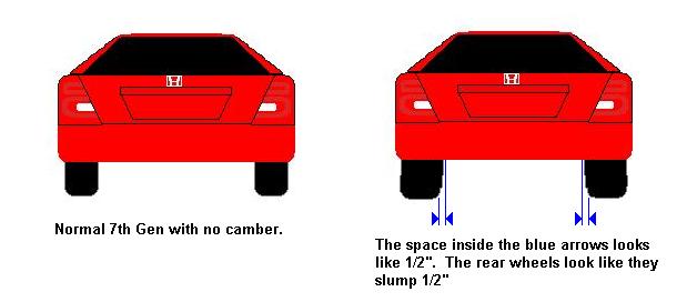

hey, how bad a camber did your wheels sit on?
My front wheels seem nice and straight, but there's something odd about my rear wheels. I noticed it back in the day even, when I still had stockies. They don't stick out much, only about 1/2 an inch more than they should (see pic for better translation).
Should I get a camber kit for this little camber? I never had problems with my tires, cept that 2 of them were stabbed recently, but that was human-caused, not accident or error-caused.

btw, my car rides on stock susp, but even when I had my stock 14's on, they sagged.

thats cause the car comes with a -.5 degree from factory

ah, i see
