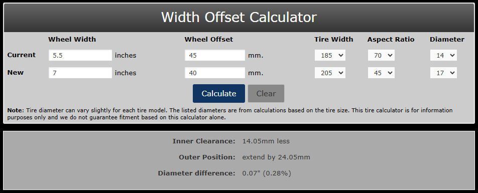

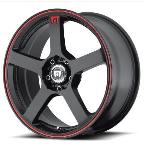

Question Think these will fit without rubbing?
I plan to lower the car first (about a two-finger-width between the tires and fender arches - maybe lower, but not totally slammed). I'm hoping avoid rubbing.

I'd personally go 215/45-17's, but those will fit without issue. I was lowered like 2-2.5" on 215/45-17s without any problems
Good rule of thumb for 7thgens. Stick between a 35-45 offset and no wider than 215's
