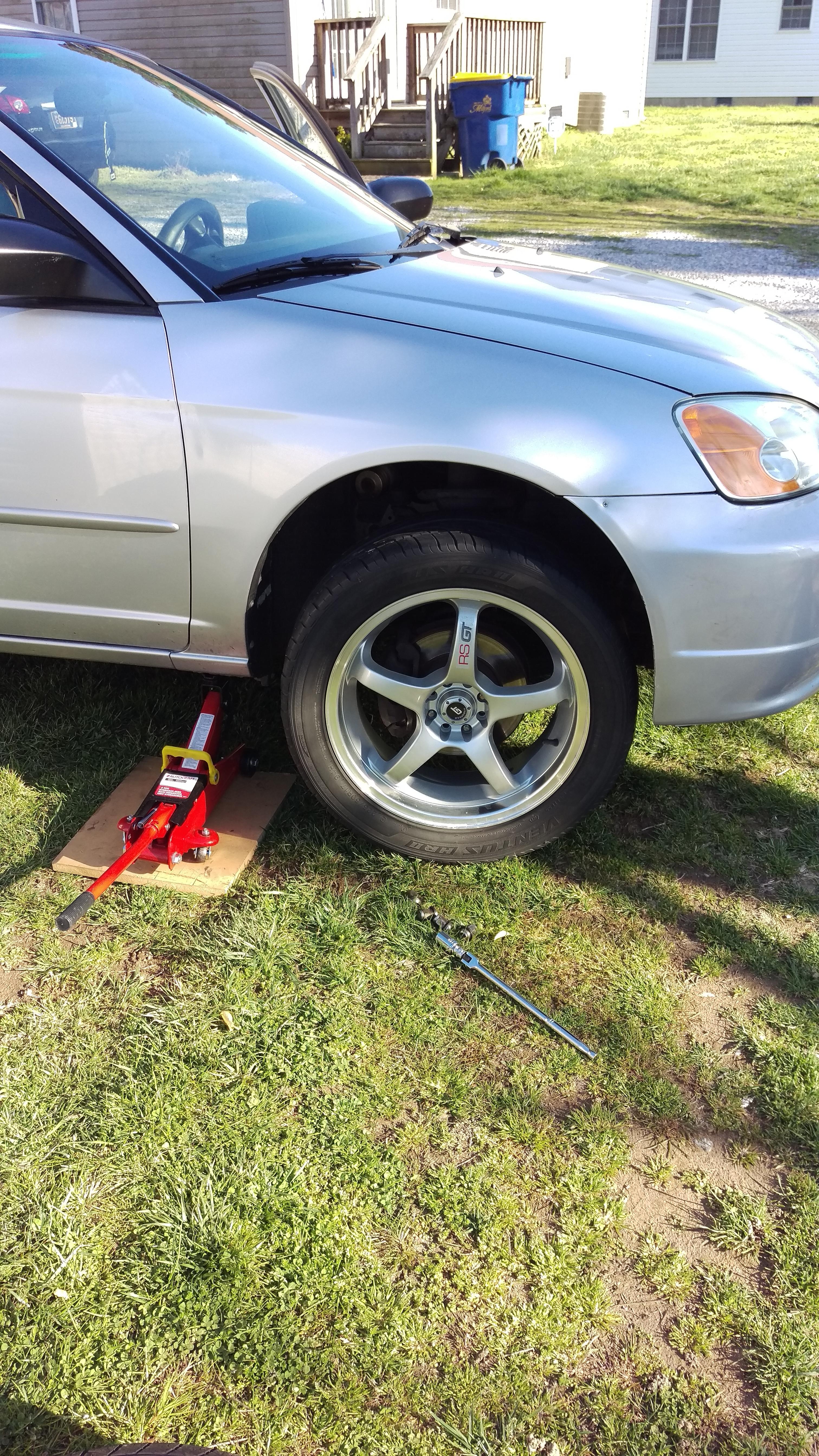

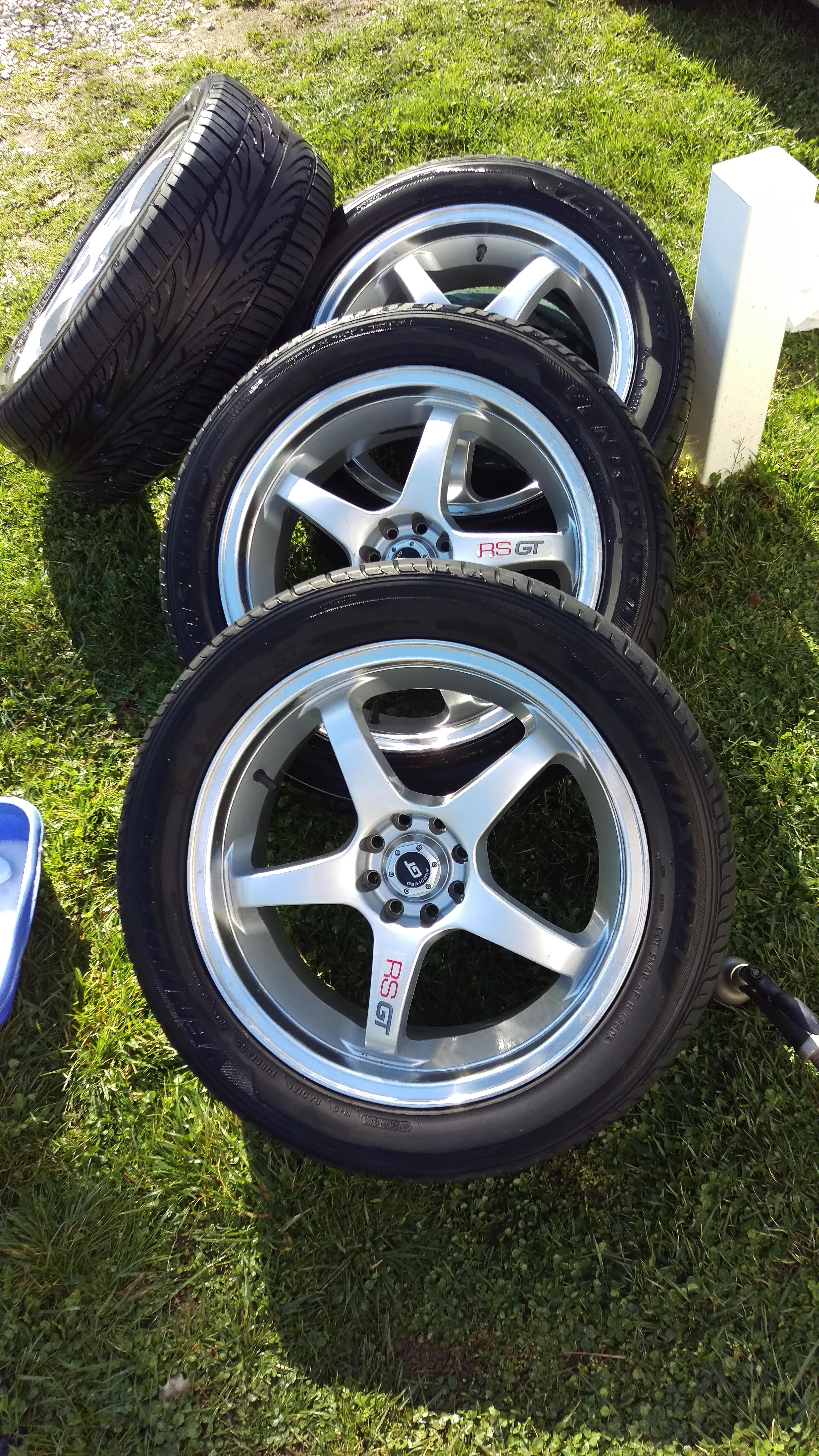

so im about to buy some lugs and spacers just need to know how thick i shouldl get, want to get enough but not too much, 55 nough
ID:	89662   Click image for larger version

225 on a 7" wide wheel might look like a balloon? Might want 215 instead?
I run 225 on 8" wide wheel.

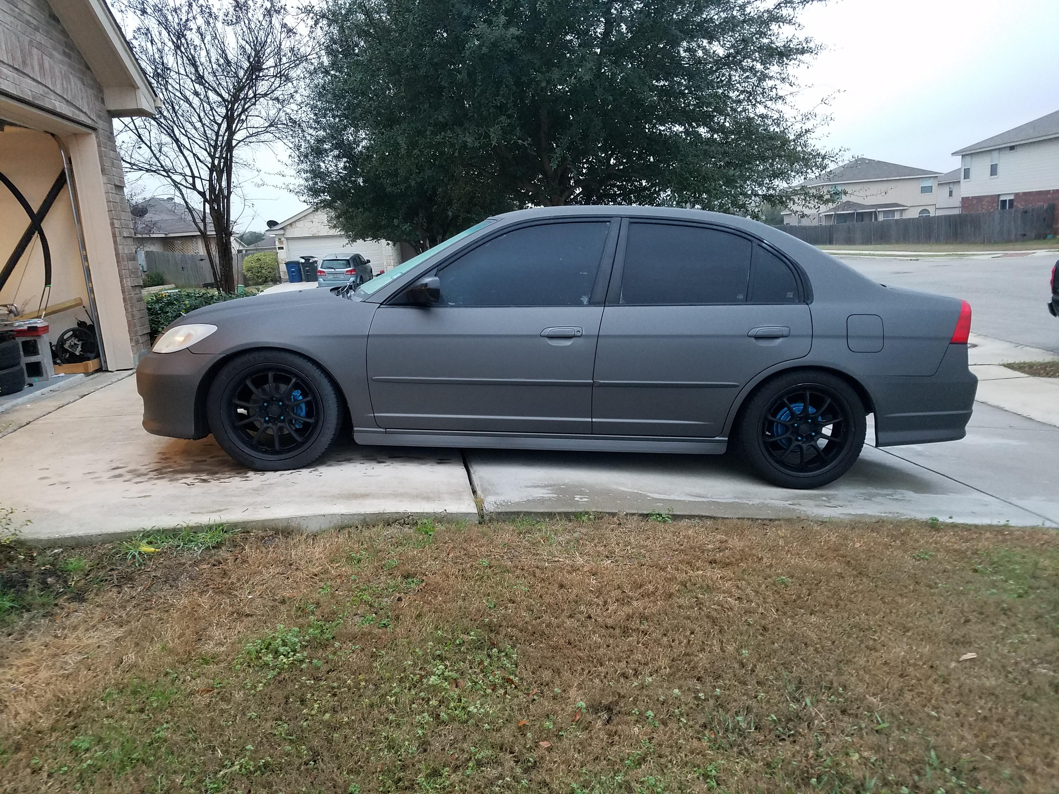

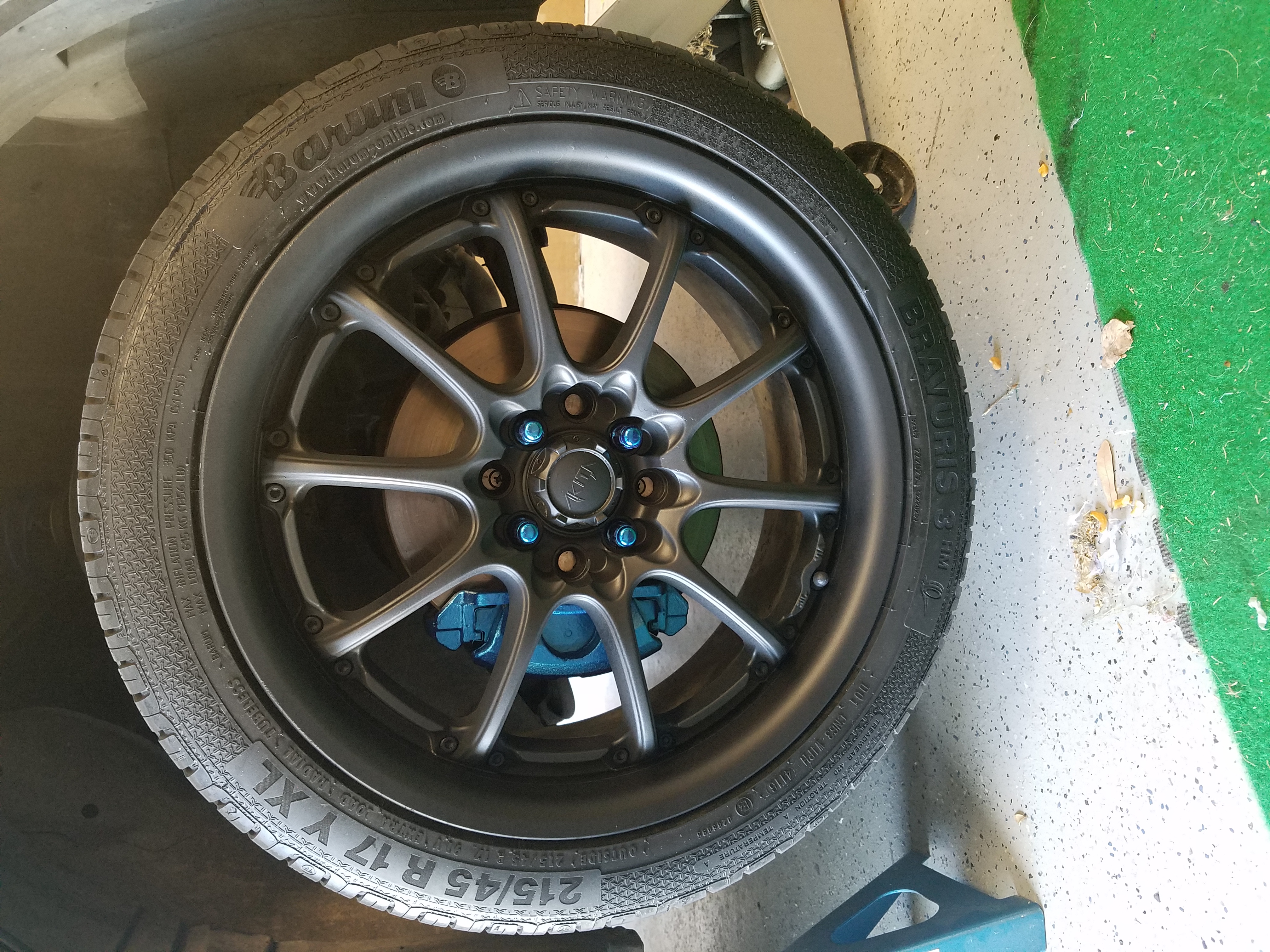

I run 215/45/17 and slammed...with no rubbing...
I like the look.
I like the feel, reminds me of racing my karts! You feel every pebble and crack in the road.
Don't like the road noise...
ID:	89678   Click image for larger version

et42 should fit without spacers.That's odd that you're hitting strut.
edit:
my car with 17x7 et42 wrapped in 215/45-17's, no spacers, lowered about 2.5"
