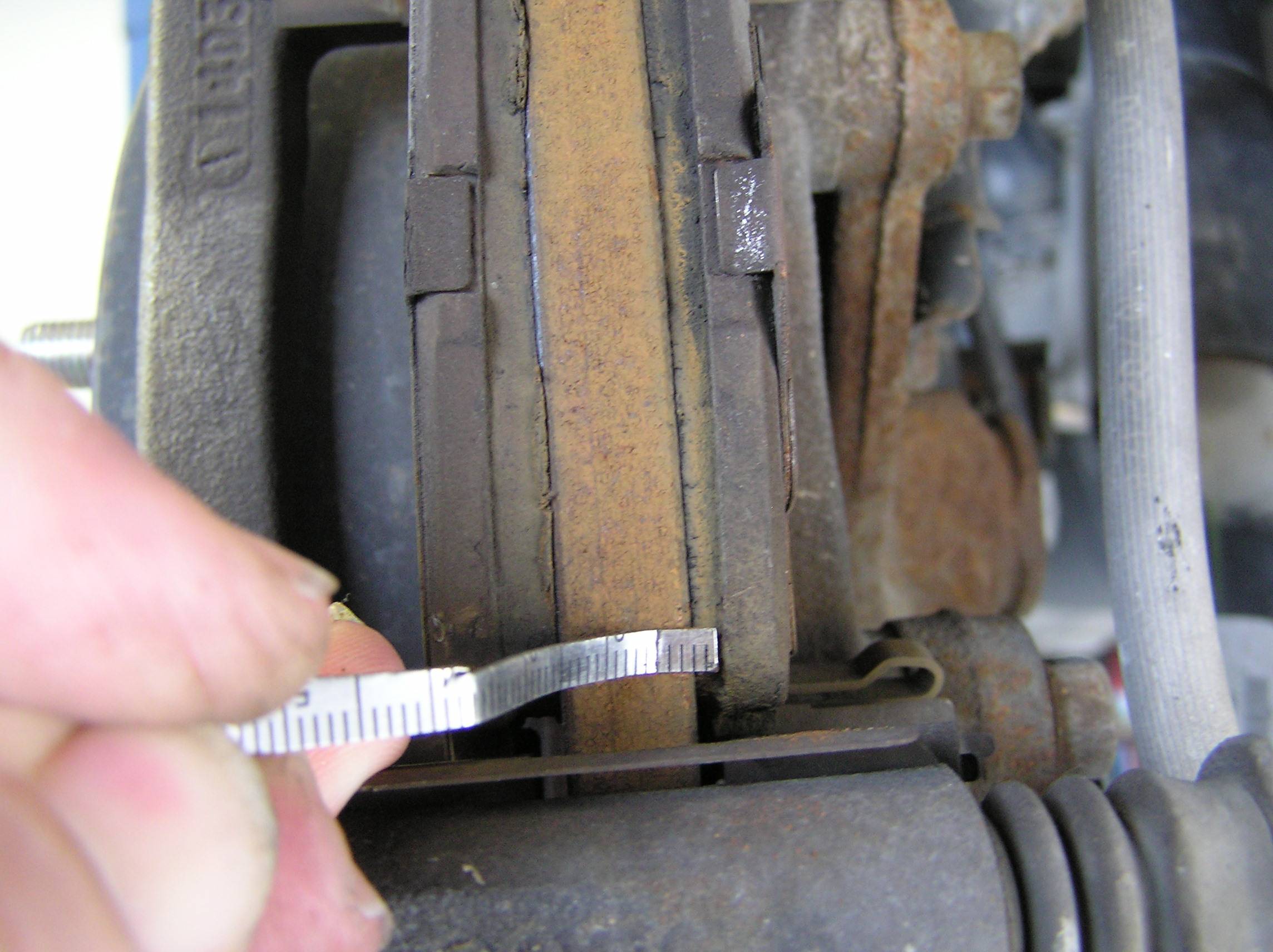

Some unequal pad wear is acceptable. Some may not be ok. It just depends.
They don't always wear perfectly even, for a variety of reasons.
I'm in the rust belt.... pads get bound up by rust, caliper slide pins get bound up, etc.
For example, this is pretty normal for me to see
