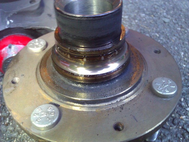

Getting a bearing split open is one thing. The issue at hand is different.
When he needs to swap the hub, this is what he will have once the hub is pressed out.....
How is he going to get the bearing race off of the old hub without any damage to the race?

When I replace a bearing, I grind a slot in the race and whack it with a chisel to crack it.
It takes a lot of work to try to use a puller to save an old race.
A new bearing is cheaper than my time and sanity. Every time.

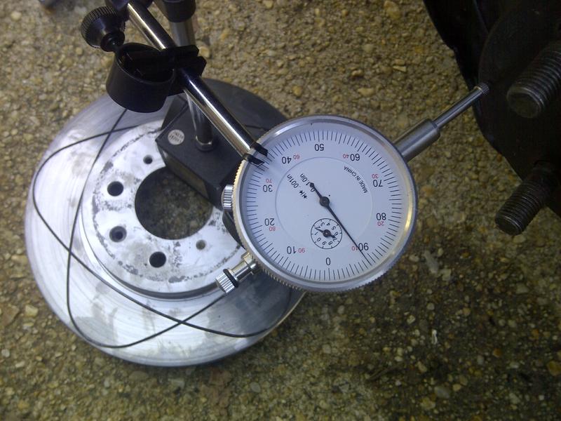

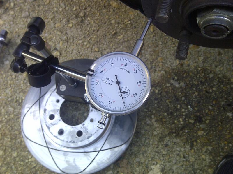

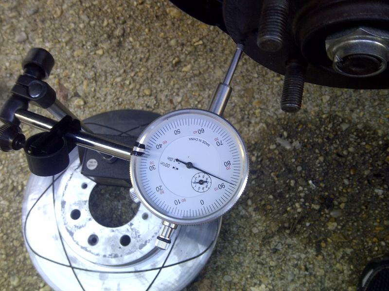

I opened everything up again and spent $30 on Dial Indicator from Harbor Fright and 4 hours.
Ok so both wheels (Rotors or Hubs) doing the same thing (Wobbling) I tried to inspect them with the dial indicator however Im not sure about the numbers though.
The left side reads from 0 to 10 and sometimes from 0 to -3 to + 20. The most consistent reading was 0 -3 to +8.
The right side(Passenger) reads from 0 to - 4 to +18
actual axles that's a smart guess. Both doesn't look good
The left one has what it looks like a bent shaft. I can see its not true. The right one is obviously bent it has hit the curb hard before (the original owner told me that he hit the curb than the stop sign). Can axles make the wheel shake like that? Do I have bent everything now(Hubs and Axles) ?

Re: Vibration around 60MPH and 65MPH when braking (New Rotors)
WTF are you measuring in? Inches? Millimeters? Miles? Cubits? Rods?
axles
Disagree. I don't think so.
Very likely it has bent hub(s).
pictures I posted
That hub does not appear to be clean, you may be measuring all the high spots of dirt and rust that way..
The dial indicator is not anchored solidly to the knuckle, that leaves a lot of room for errors.
Someone else ideally should be rotating the opposite tire to make the measured side spin, this eliminates human interference. The act of putting hand pressure one way or another can cause undue flexing and add to measurement errors.

Sorry that picture is taken when I installed the old rotors. Trust me I swapped new and old rotors like 5 times and cleaned the hub with wd40 and a wire brush. Same measurement. This is the first time for me to use the dial so I don't I did a good job at it.

So I took everything out again today.
Removed the axle passinger side and tested the hub with the rotor and its shaking (Dial wired reading again)
Removed the rotor same thing (Dial also shows that 0 to -0.0003 to + 0.0008 or 0.0010)
Put everything back and went to a local shop. They said you have bent axles and hubs and its better to change everything at the same time. Went to Autozone and they said they will replace the bearings if I bring the old ones back even in peaces
