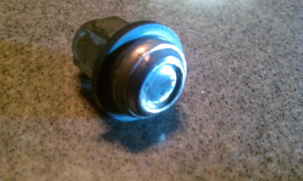

Any repair thoughts =( ?

Re: Broken Lug Nut
Is that a front or rear wheel?
Yeah you have to remove the hub to replace it. Shop should fix it for $100 or less.

Re: Broken Lug Nut
Its passenger side front
That would be pretty cheap..
The knuckle needs to be completely removed from the car, if you plan on DIYing the removal then BlueEM2 made an excellent write up that's located under suspension DIYs. Once the knuckle is removed the hub will need to be separated with a hydraulic press to give enough clearance for the wheel stud to be pressed out, that often damages the wheel bearing and it's advisable that you also replace it before having the hub pressed back together. I would replace all four studs, not just the damaged one.

Thank you so much guys, i was worried it would be a weld job and something fierce to pay for!

Originally Posted by Running Riot
i got one in without taking the hub apart... come to think of it, I didn't even take the knuckle off the car, as I recall I think I just popped it in from the back and tightened the lug nut on and it pulled it through. It was a couple years ago. You usually break them if you don't have the threads on the right way and Hulk them bitches in place on finger ****em first until you feel them bite then tighten em down.
To the guy who posted to get arp studs.... seriously why would that be sound advice? instead of spending a 5er, some beer, hand tools, and a couple hours fixing a simple problem; lets take ALL the studs off the car and put on some equipment that will never see use that justifies a necessity for it... come on bro
I always wondered if you could use the stud itself to hold the wheels on like the BMWs do but i've never been motivated enough to try it....
Whole hub has to be removed, and bearing should be replaced. I did this last year. But I went out and bought a new hub with new studs allready in place. And a freaking bearing. 200$ from dealer!!
