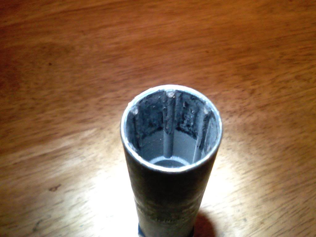

so i was doing an oil change and on the last lug i snapped the tool... this is not good! what if i blow a tire? and how am i going to change my suspention in the spring? any way here are some photos hoping you guys know where i can find a new one. if worse comes to worse how can i cut the lugs off?
and my emanage, for now a really expensive paper weight.
the tool is about the diameter of a nickel, maybe a quarter. it's smaller then the stock lugs and has 6 points of contact which slide into 6 grooves on the lugs.

looks like the standard muteki key for their tuner lug nuts. thats the reason i like em so much. if it breaks (and they do rust up fast if you dont keep it clean and indoors), i just order another set. they are dirt cheap too a set of 20 for $50 or less sometimes.

awesome! thx man your saving my life. now that i know what i think i'm looking for i'll do some real measurments and hopefully order them.

If you can't find a key that fits, you can take a socket and pound it on to remove the last nut. Kind of a last resort thing.

^all four nuts use the same key. hey look they sell the key separately. $10 shipped on ebay to anywhere.

get a slightly undersized socket pound it on with a hammer hit it with an impact and it will come right off nock the old lug out of the socket repeat. replace with other lug nuts.
keyed nuts are a waste if some one really wants your rims they are taking them
