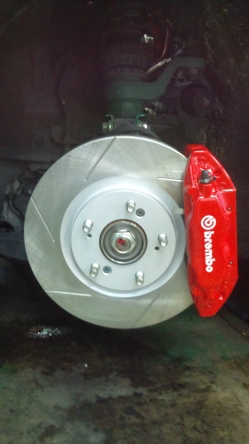

I recently upgraded my front brakes and just wanted to let other users know in case anyone is thinking of doing the same. My car is basically the same as the EP3 Civic and had stock calipers with slit rotors, which were good. But I found a great deal on a set of Brembo calipers from the Japanese Civic TypeR (FD2). I did some studying and found they would fit my car too, so I went ahead and bought them. I had to buy some new rotors (Honda S2000) and they bolted on with no problems using stock brake lines. Great upgrade. Want to see more? Visit my page.
