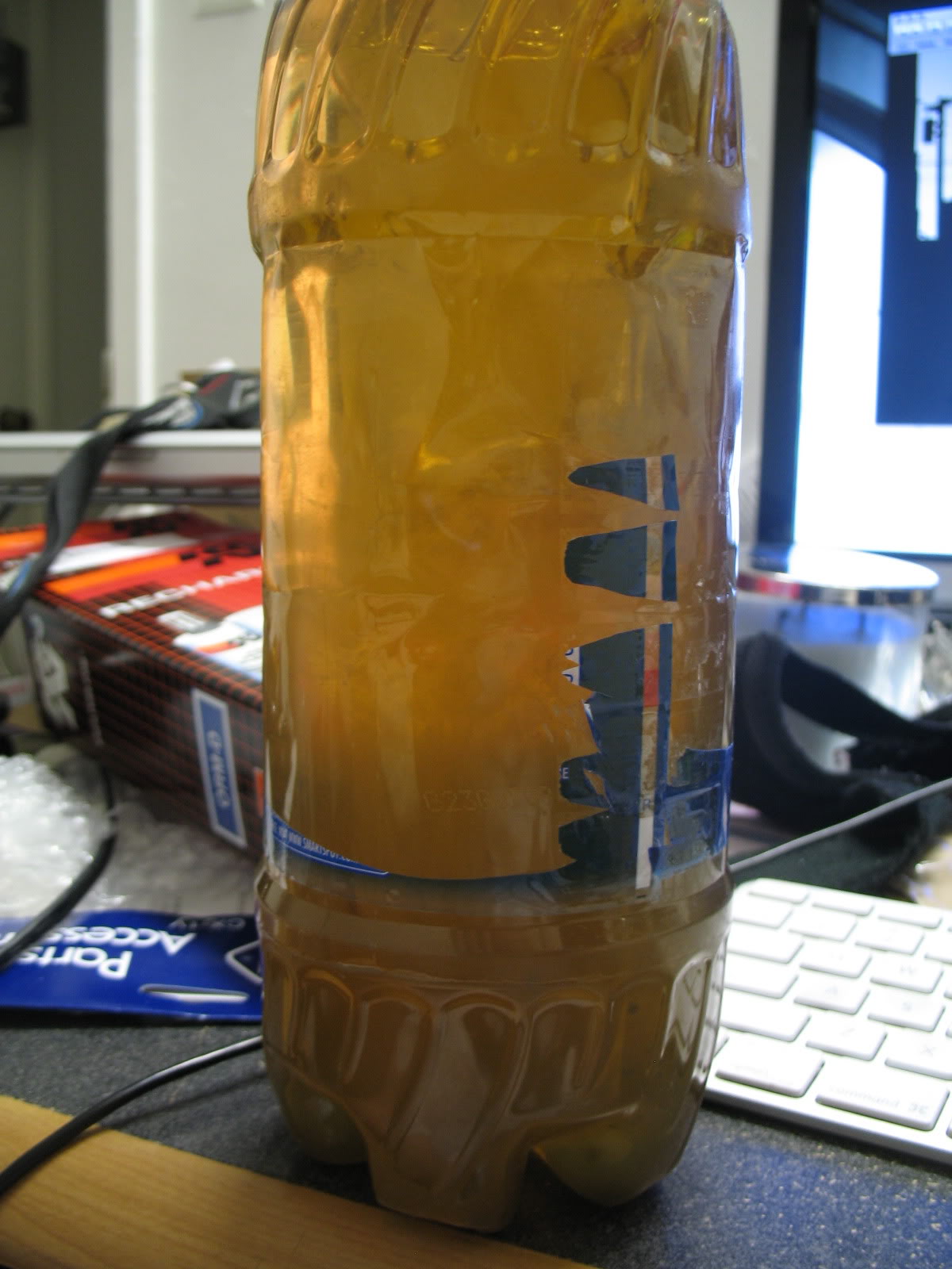

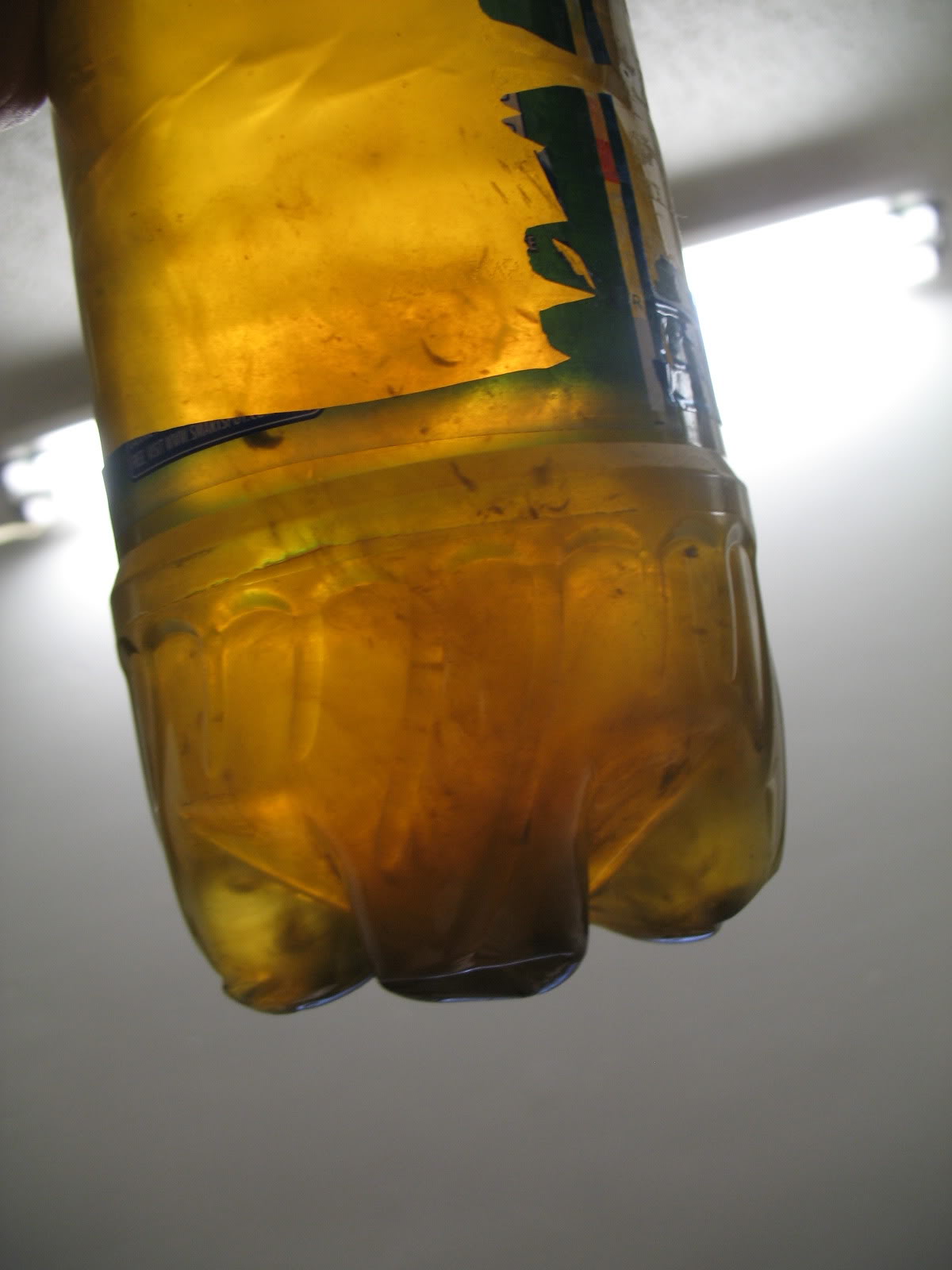

^you do NOT want to suck out the brake fluid from the master.
just depress ur brakes, bleed them, and then refill ur master. DO NOT LET THE MASTER RUN DRY as this will cause air bubbles to get in ur system.
bleed ur brakes untill "clear" fluid comes out and you will eventually flush the entire system.
1. i used up a whole litter of brake fluid and then some when i bled/flushed my sytem. there is NO need to use RBF600. unless u have alot of $$$ to spend because u willl need 2-3 cans, and at $20 dollars a car....u get it.
