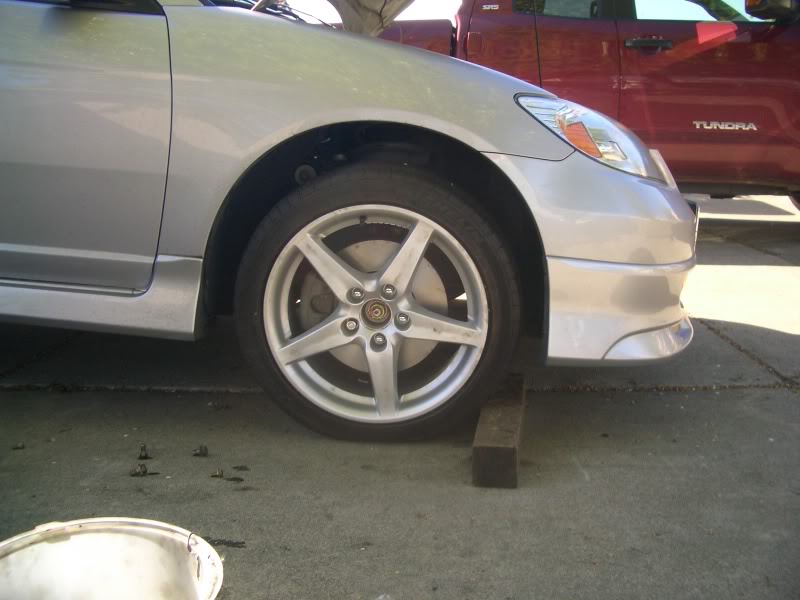

This lug swap and brake conversion is for people still have D17 motor.
But if you want to put in a K series motor this works as well.
Parts:
-RSX Base knuckles, front
-RSX Type S Knuckes, front (use this only if you have a K swap)
-RSX Base or Type S / SI hatchback 04-05 “EP3” knuckles, rear
-RSX Base or Type S / SI hatchback 04-05 “EP3” Brake Caliper Rear
-RSX Base or Type S / SI hatchback 04-05 “EP3” E-Brake Cable
-RSX Base or Type S Brake Lines for each Brake Caliper (by new lines)
-RSX Base or Type S Brake Caliper (check seals)
-RSX Type S Front Brake Caliper brackets.
-"I also would suggest to swap out your brake booster for RSX Type S, brake portioning valve, and Brake Master Cylinder. This is also going to require a little rewiring of your brake lines to the master cylinder."
-By new Brake pads and rotors. (You can buy brand new OEM Brakes from ACURA which will cost you the most money, or go after market which are better for harsh driving I went with EBC pad and rotors).

I really like those Honda rims....where do you go to find Honda rims like that?
Old Sep 24, 2012
Aetoc's Avatar
Joined: Jun 2009
Posts: 574
From: Ontario, Canada
Rep Power: 211
Aetoc will become famous soon enoughAetoc will become famous soon enough
Re: 5 lug and brake swap information em2, es1 01-05
Those are Acura RSX rims with Honda center caps
