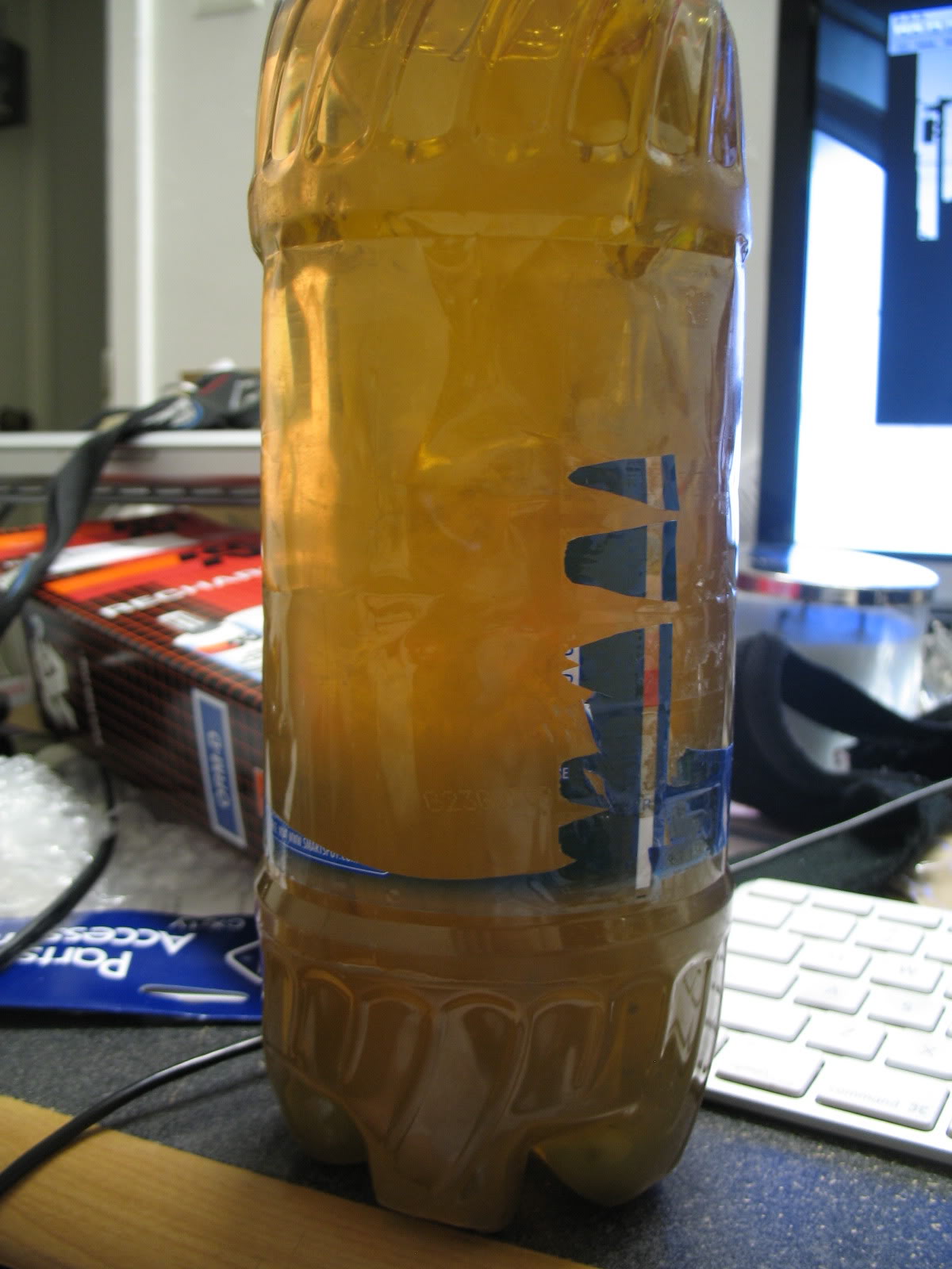

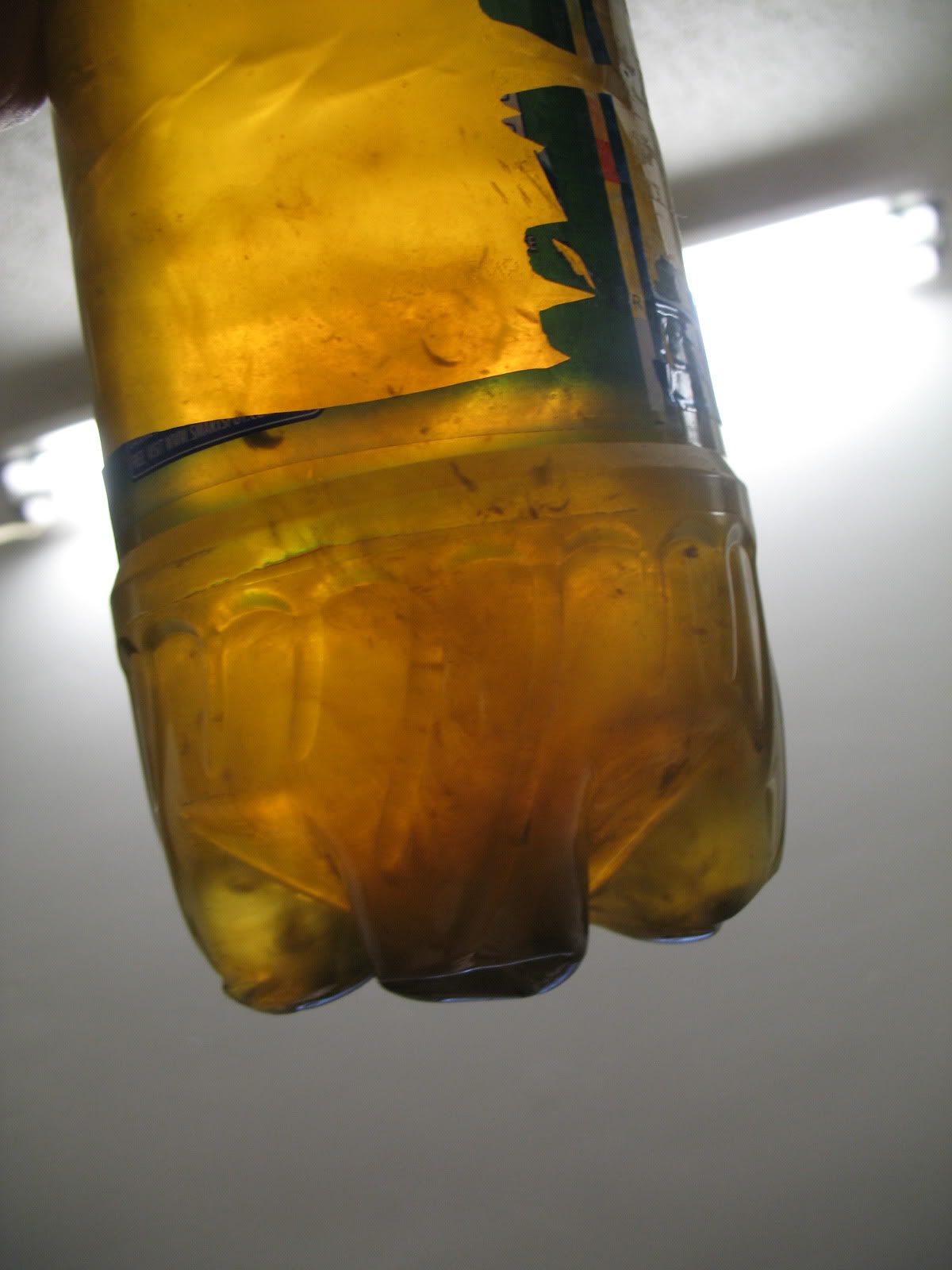

i recently changed my rotors/pads and i flushed my fluid. its been about 3 years since i flushed the fluid and here is what 3 year old fluid looks like:
(i took n saved these pixs for those idiots that challange the idea that you dont need to change out ur brake fluid until it reaches 5+ years or whatever)
take a close look at all the **** that's in there....

once it turns brown, ur rated boiling point lowers dramatically even if u some EXPENSIVE *** motul RBF 600 (which is what i use on my R1 bike). that **** goes for 15$ a small bottle.

most likely that ur civic's brake fluid has never been changed out and all the old fluid is still in there... putting new fluid in is great, but all the new fluid is in the resivor and not in the caliper where it counts most.
thats why you flush it.
NOTE: when i say flush i mean bleed ur brake fluid until only new CLEAR fluid comes out.
i "flushed/bleed" 1.5 litters of nasty old brake fluid. yes i know the whole system isnt 1.5L but i kept putting fluid in and bleeding the lines jsut to ensure all new fluid is in there.
good brake fluid looks like the clear one. bad looks like the left.
^bad
get the point?
