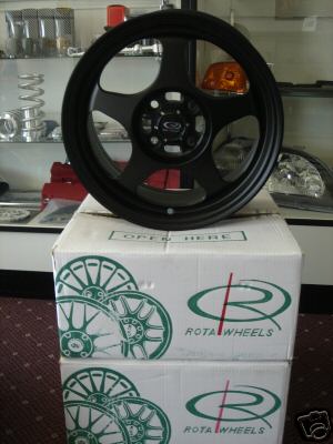

Hey Guys ... Im downgrading from 17's to 15's with in the next few weeks. 300 miles of highway driving per week isnt that comfortable with 17's and plus .. Im tired of the look of the wheels and was willing for a change.
My options right now are:
1) 04/05 Oem 5spoke Alloy wheels which are perfect factory specs.
2) Replicas of Rotas which are about $600 with tires (15inches with 205./50/15) installed at this local wheel place.
3) Theres a deal on original Rotas on ebay for $465 with shipping (just wheels) which im considereing the most .. How much would tires cost if i get these ??
The most important thing is that I have no clue abt OFFSET and stuff when it comes to wheels... Can someone tell me if 15x6.5 4x100 meant for our civics please ??? i know that 4x100 is the lug pattern but i have no clue abt offset stuff.
Does anyone on the forum have experience with these Rotas ??? i heard they are a good name brand ... but nothing more ... Thanks

15 inches is the width of the rim, and your 6.5 is how thick the tire is (6.5 inches in this case)

Its a little more complicated then that.
Wheel offset
The wheel's offset is the distance from its hub mounting surface to the centerline of the wheel. To determine wheel offset:
* Position the wheel on a flat surface and measure its overall width.
* Divide the overall width by two, then subtract this result from the backspace value.
Offset = Backspace - (Rim Width ÷ 2)
The offset of a wheel can be one of the following three settings:
Zero offset:
The hub mounting surface is even with the centerline of the wheel.
Positive offset:
The hub mounting surface is toward the front or wheel side of the wheel. Positive offset wheels are generally found on front-wheel drive cars.
Negative offset:
The hub mounting surface is toward the back or brake side of the wheel's centerline. "Deep dish" wheels are typically negative offset.

me i have a 15x8 wheel with a 40mm offset *(for slick)*, OEM is 45mm

I went from 17" last year to 15" this year as well. 15 x 6.5 with 205-50-15 tires and 40 offset. They do look small from certain angles .. but i can live lol.
