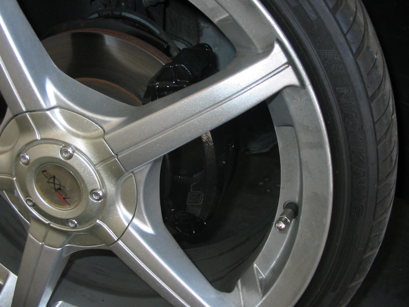

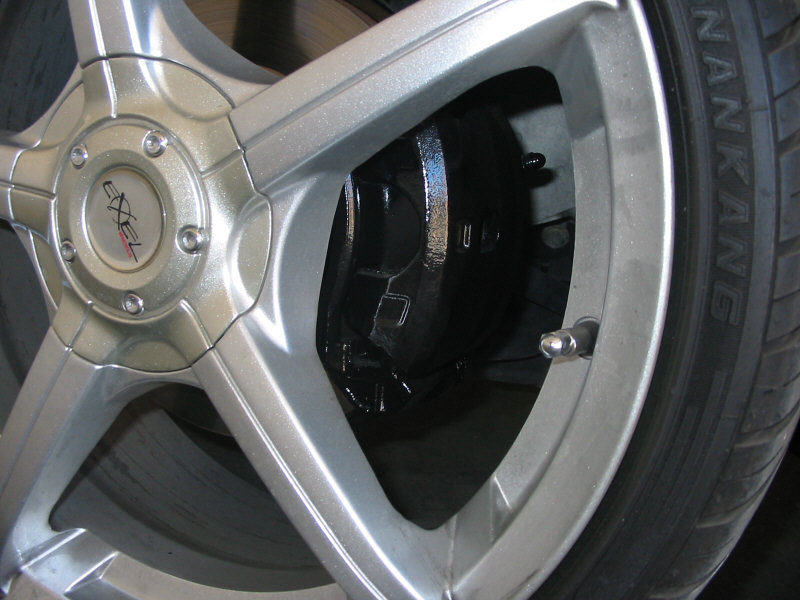

here's a couple of pics. they're not the greatest, but they should give you an idea of what it will look like. please ignore the dirty wheels. i'm swapping out the rotors for some brembos later this week and didn't feel like washing the car until then.

nice, did you use the caliper kit or what.? List what you used so i can get it from autozone tomorrow.

i just used the 500 degree duplicolor paint in a rattle can. brush off the loose stuff and spray on 4 light coats. easy as pie.

did you sand the caliper off or what, Or did you just sprayed it on top. ALso how did you rub it off.
or should i just go and get the 15 dollar kit.???? The kit is not spray. Its paint.

i just used a wire brush to get all of the loose debris off, used a dremel to get what the brush couldn't reach and then sprayed the paint on the caliper. 4 coats and then done.
