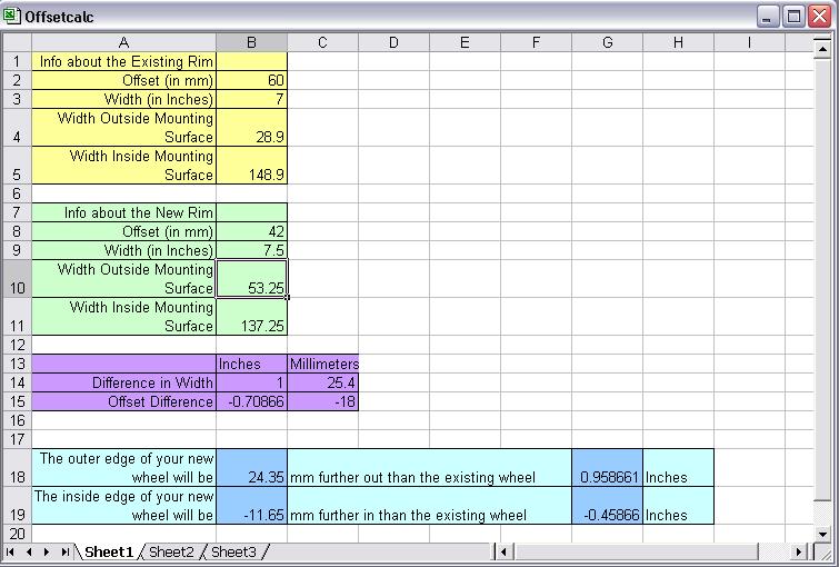

well, I was just trying to decide whether to get the +48 offset 17x8 wheel or the +42 17x7.5 wheel ... I would get the 17x8 wheel, but I'm afraid that would be too far in...
would a 17x8 +48 offset wheel be further in than a 17x7.5 +48 offset wheel?

According to my trusty offset calculator....
Any number that comes out negative goes the opposite direction of what the words next to it say (if it says 'in' but comes out negative, it actually moves out.)
ID:	50741   Click image for larger version
