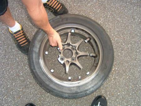

Have anyone try this wheel 16" on our Civic ?!
Would it break eaily ......like the picture?!

a lot of factors go in to breaking a wheel like that. such as, did he hit something? Sliding sideways in to a curb would do that. also, how siticky of a tire is that? and what was he doing when it broke? Autocross? From the look of the tire (Dust and dirt) my guess is that the wheel was broken becaues of an accedent and not just from stress on the wheel. i.e. the wheel broke due to user error.
For your question, yes it could be assumed that the lighter the wheel, the more suceptible to damage it is. its the price you pay for performance.

Thats an Azenis on the rim. Thats pretty a sticky tire, and looking at the way it broke, he slid into something and smashed it. Its pretty tough to just shatter off all the spokes like that just by laterally stressing it. I'd call driver miscue on that. I know a few people racing on Konigs, never with a problem.

Dude how the hell can you tell from looking at the pic?

^^^ To the right of his hand... you can see 1/2 a K then the EN. Across from it I see an A. The lighting glares out the rest of it, but it looks like an otherwise blank sidewall. Its gotta be a Falken Azenis.

What im wondering is how he broke that much of the rim, and didnt get any tacos (where the rim is bent inward around the lip) or any dents along the side (if he were to have slid into something).
I dont wanna be an ill informed bitch, but that looks chopped to me. As to why someone would chop a pic like that, i have no idea.

You can go off a track, hit soft dirt, gravel or mud, the tire would dig in but the car wants to keep going. Thats enough lateral loading to rip the rim like that. Thats not hitting the curb, but it sure as hell could do it.
