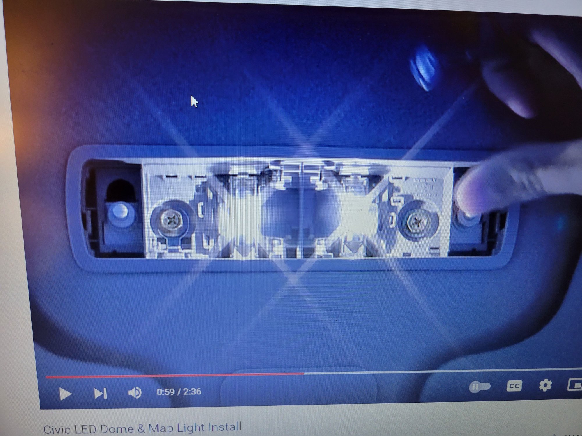

Has anyone done this mod? If so, are the screw holes or brackets already built in or attached under the ceiling carpet trim? I know I'd have to cut in order to get the new lights to fit and that I'd have to wire them up, which is not hard. I did not see this particular mod when I searched for new mods on the Civic. Just wondering if anyone has done this before. I can get the map lights cheap, but was wondering if the brackets were already there...

So I took a picture of a Youtube video with the plastic light pieces out. Looks like there are two screws that hold the map light trim in. I am wondering if the screw holes are there in the VP edition...

So there is only one wire connected to the front map/reading light assembly, and that wire color was WHT/BLU. It's grounded by the screws that hold the assembly in, which is a great design. I just hope that on my VP that those screw holes are there when I pull back the headliner.

In addition, the front map light area under the ceiling area by the rear-view mirror on the DX and VP sedan and coupes DO NOT have the mounting holes for the front map lights. So that means that I have to cut the ceiling headliner and glue the lights to the headliner and then wire them to a fuse under the dash. I have no problem running wires, which is easy, but the lack of mounting points is disappointing. Not sure why they couldn't have included the screw holes, just under the headliner.
