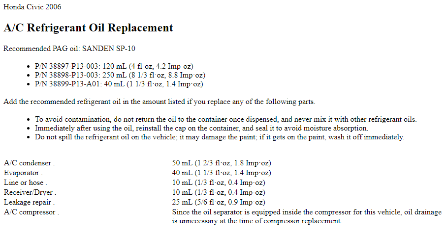

I need help with my a/c on a 2006 civic lx..I'm replacing my compressor and condenser and need to know how much oil I need to add...I've asked a dozen people and got a dozen different answers!...please help!

Re: A/C problem
From the service manual.
