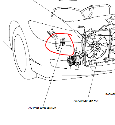

Im new to the group I just got my 2010 civic Love it Im trying to get the ac going I think the low pressure switch is bad but cant find it any one know the location ?

Somewhere around here.

thanks so I replaced the switch and recharged but still wont come on by itself seems to me there might be a switch on the comp there is the red clutch wire and two other dark wires thanks for helping out

Check the compressor relay.
You will need to start troubleshooting with a multimeter.
