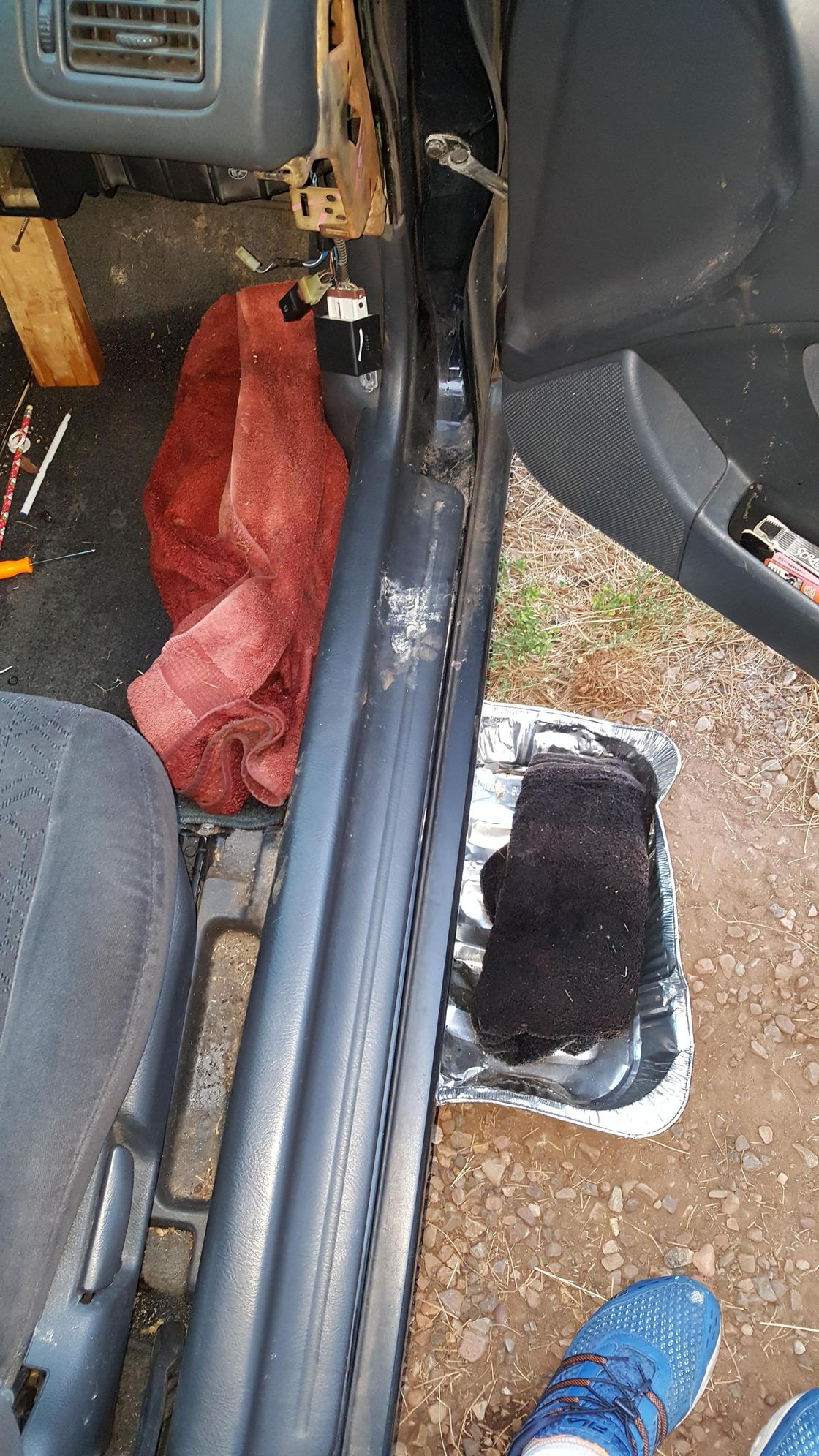

I replaced the heater core in my 2000 Civic HX and got a brown puddle for my trouble. My old one didn't do that, so the new one is actually worse!

I replaced the radiator and bypassed the heater core three years ago. Some rust came out of the hoses when I connected them to the new heater core.
I did not smell anything yesterday, but today when I went to change the towel and air out the car it definitely smelled.
Also, I only put distilled water in there once I realized that the cooling system failed. I did not want to spill coolant all over.

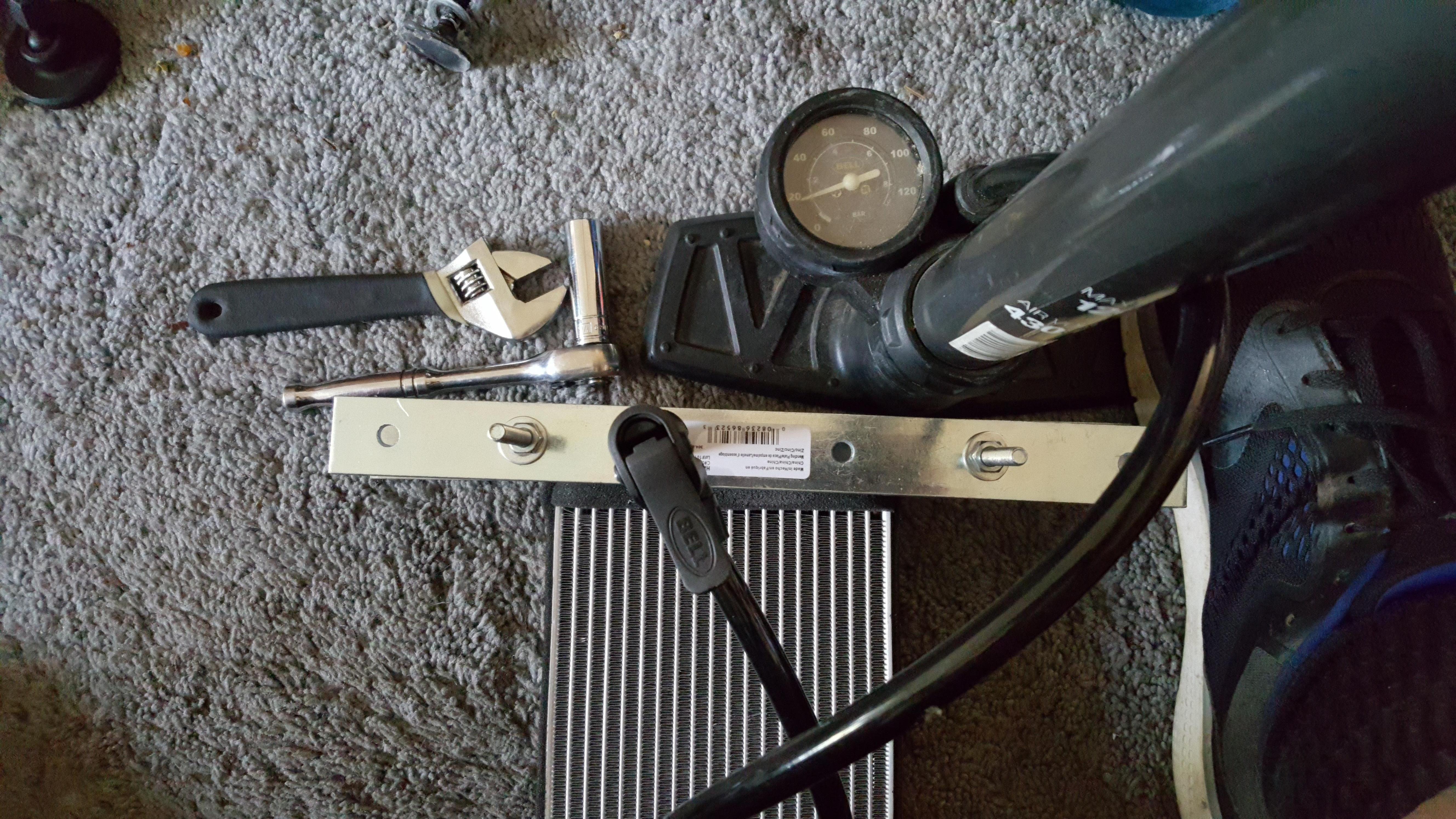

Hey guys, I thought that I figured out how to properly test a heater core before installing it. I trimmed down a Schrader valve to fit in one hole, inserted a rubber plug into another, and used these two mending braces, bolts, washers, and nuts to keep the Schrader valve in the hole. The cooling system is rated for 16 PSI, so I took the bike pump to 16 PSI, set a timer for an hour to ensure that the core holds pressure, and just a few minutes later the pressure was gone.
Is the problem with my core or my rig?
Oh! How do I remove a rubber stopper from a hole?! My rig pushed it almost all of the way in! Name:  DAySJak.jpg

HOW would someone locate an air leak in a tire?
Pressurize it.
Spray it down with a mixture of dishsoap and water, see where bubbles form
OR
Dunk the whole mess underwater and see where the air bubbles come from

The heater core fins trap a great deal of air and I would be unable to distinguish leaking air from bubbles just trapped by the fins.
Old Jul 10, 2020
Re: Have you ever pressure-tested a heater core before installing it?
Think less
Bubbles from trapped air would eventually stop.
Bubbles from an active leak would be seen as long as you keep pumping air in.
