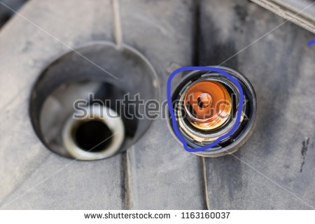

ezone i agree on not leaving any synthetic oil too long 15-20K is way too long to leave in any Honda i use to work in a autoshop years ago when i did oil & filter changes i could always tell the difference from the ones that did extended oil changes. and the ones that didnt Just by simply taking off there oil caps and looking at How dark and stained they were. So you see how stained and dark that oil cap looks like, so imagine what the inside of the engine looks like from doing extended oil changes? keep in mind the oil Cap & dipstick are the Clues im thank full that hondas still have "oil dipsticks" to check oil level and condition because alot of the newer German vehicles i have seen dont carry it on there engines. checking oil level is on the dash screen. retarted if you ask me

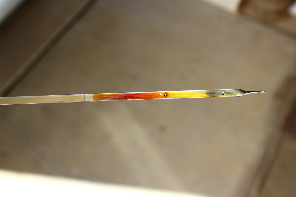

Okay, I am about to do the oil change. I just checked the current oil, and here's what it looks like. What are your thoughts? It looks very clear to me, but the level is very low. No? Last oil change was done on May 02, 18 by the dealer. I do not know what kind of oil they put it. I didn't ask.

ouch its about a tad over 1 full bottle low on oil are you Just changing oil based on the % percentage maintenance minder on your dash when to change it? and never checking oil level in-between ?
Looks nice and clear, but is it really 3/4 inch above the crosshatch? Flunky lubie put in 4.5 or maybe even 5 quarts in an engine that only takes 4 quarts for an oil change?
Pull dipstick. Wipe it off. Reinsert dipstick fully, and immediately pull it out. Read level.
That's awfully clean looking oil in there.
How many miles have elapsed since the last oil change?
That's important info too.
Maybe flunky lubie didn't remember to reset the maintenance minder oil life. (a real common issue)

oh yes its low but looks clean try checking your level more often then not so it dont get down that low. lol
I am ashamed to say this is the first time since I bought this car that I touched the dipstick.
The dealership must have reset maintenance minder. Otherwise, the annoying warning wouldn't have gone away.
Total miles between last oil change is 6,417 (Last oil change was at 51,246 - I am now at 57,663)
I think the oil level was that low because I looked at the dipstick after the car was already on the ramp, so the reading could be compromised I think. I also waited until the maintenance minder displayed "Service Due Now."
The oil didn't look that clean/clear after I drained it.
