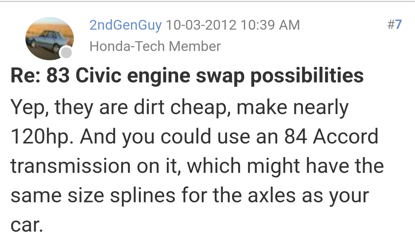

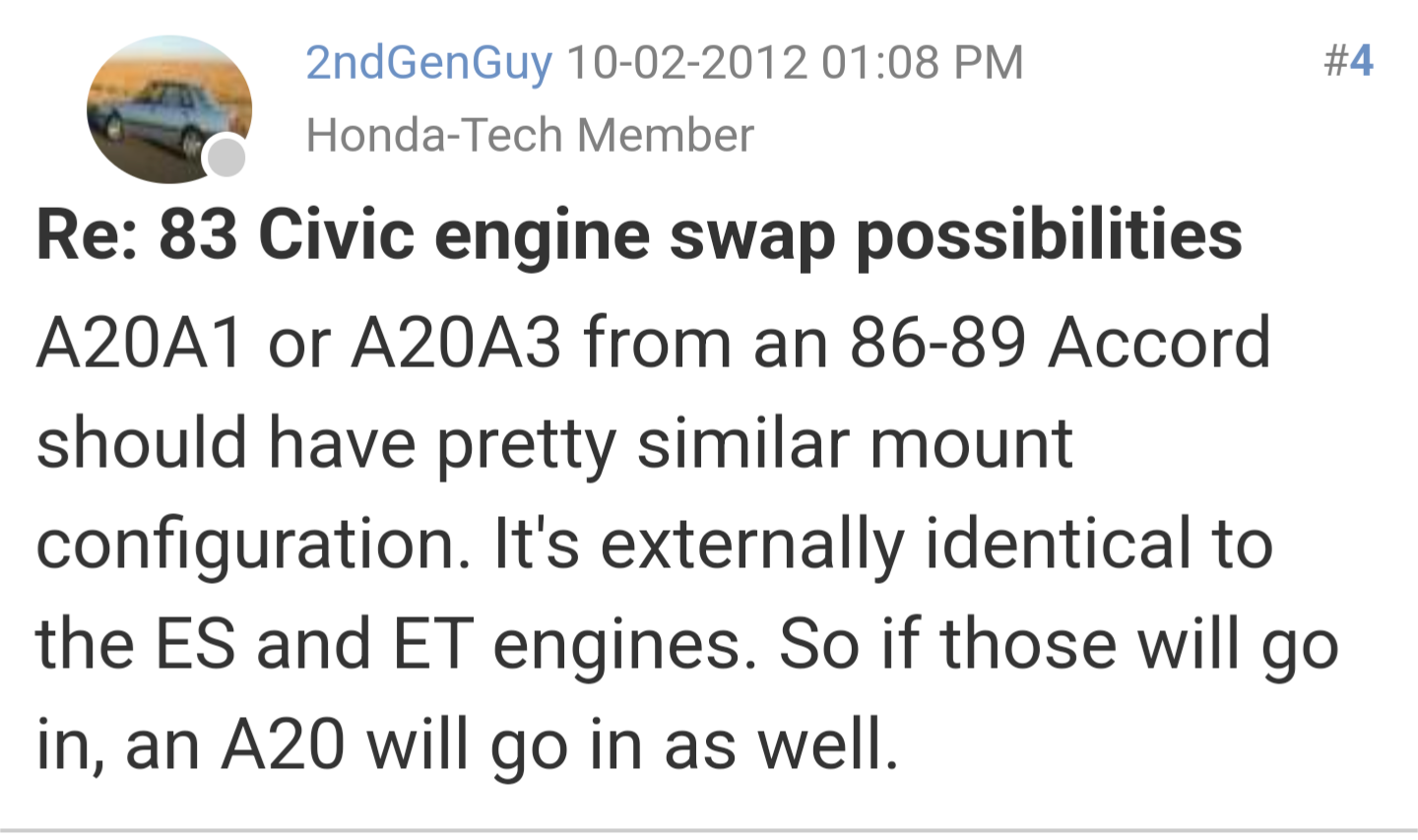

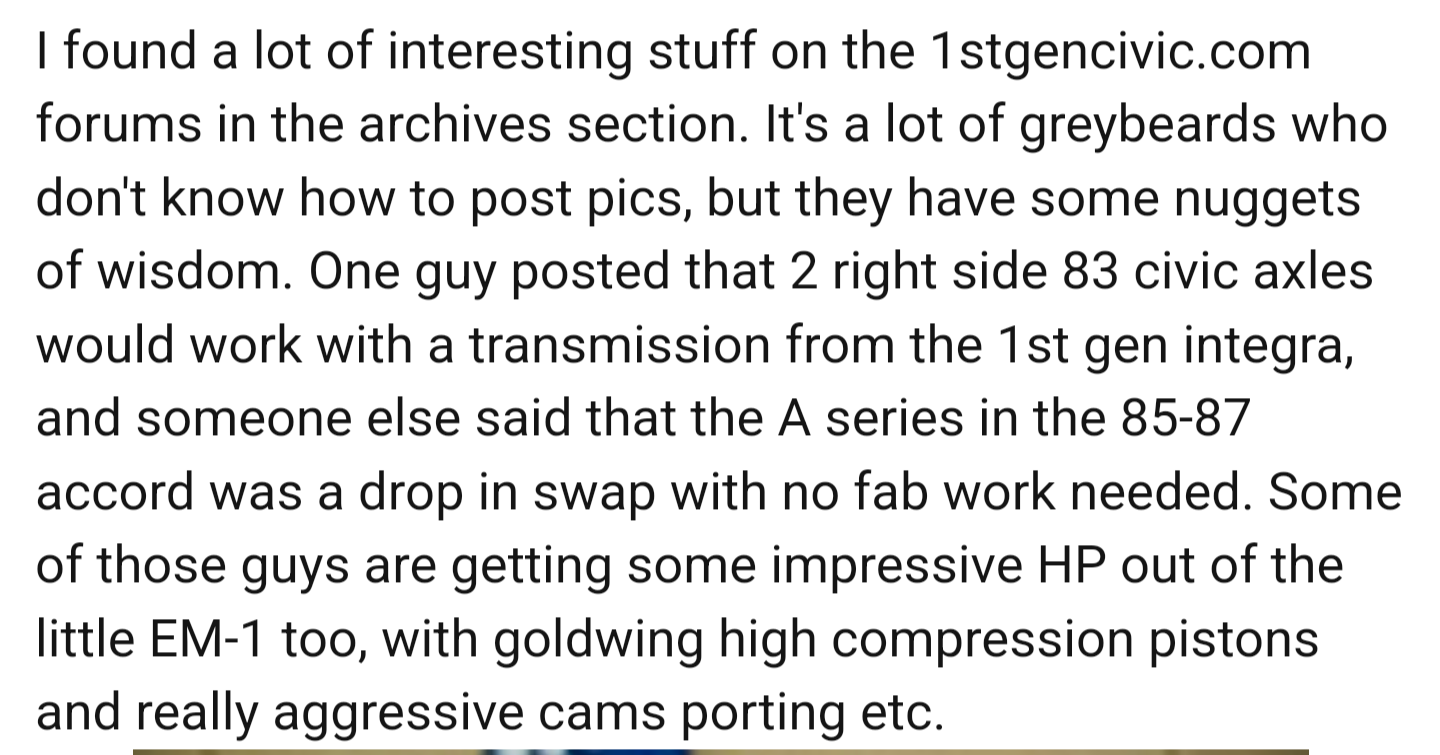

  1. I've been on the hunt for a fun little car under 10k. I found an 83 civic 1500s 5spd 2 door hatch I'm considering. It in fairly good condition. I would want to swap with something fuel injected. Not looking for a race car just something fun/reliable. I've been doing some research and I've come across a few comments that say the A20A1/A20A3 out of the Accord would be a pretty straightforward swap. I can't find any information or a build thread for this swap. Does anyone here have experience with this or know if a good resource for information in regards to this swap. I will attach screenshots of what I have read.
