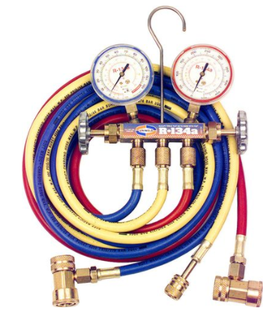

I don't know. Would there be an adequate way of testing without buying a special gauge? I may be able to borrow one from a friend. Something like this?

You need an A/C manifold gauge set to test, my local parts store rents this tool. Just put down a deposit, return the tool when you're done and get everything back.
Oh, that's a good reminder. Some stores in my area do that too. I'll see if I can obtain a gauge one way or another.

I tested the AC pressure switch for continuity with the key OFF and got nothing. I jumped the switch, started car, and heard a hissing noise coming out of the vents, didn't want to run it too long without knowing if that was going to be damaging. Do I need a gauge that tests both high and low? Or would one used for filling the low port be acceptable?
