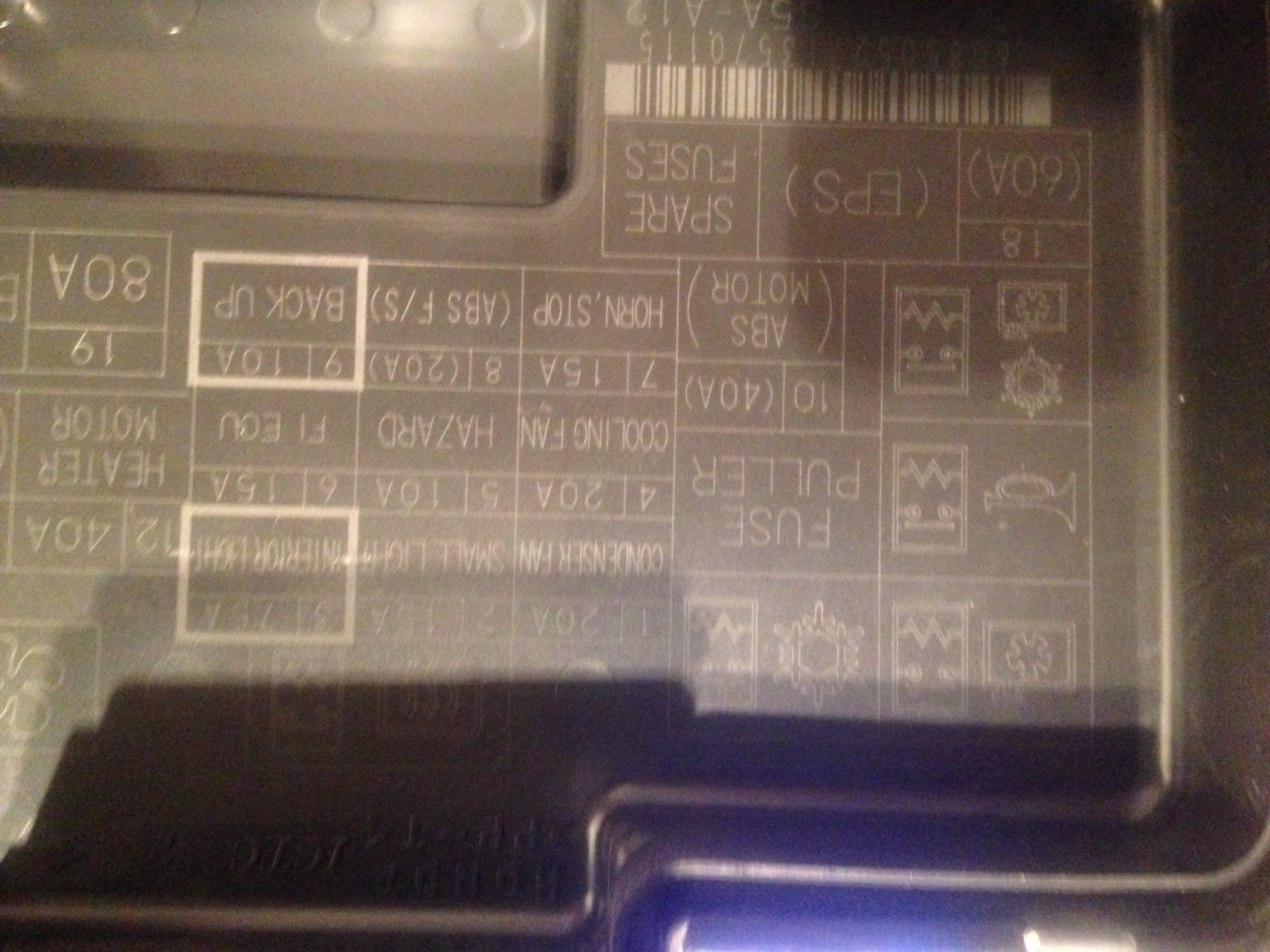

light inside does engage, fuse under hood good, fan turns on when engaged..

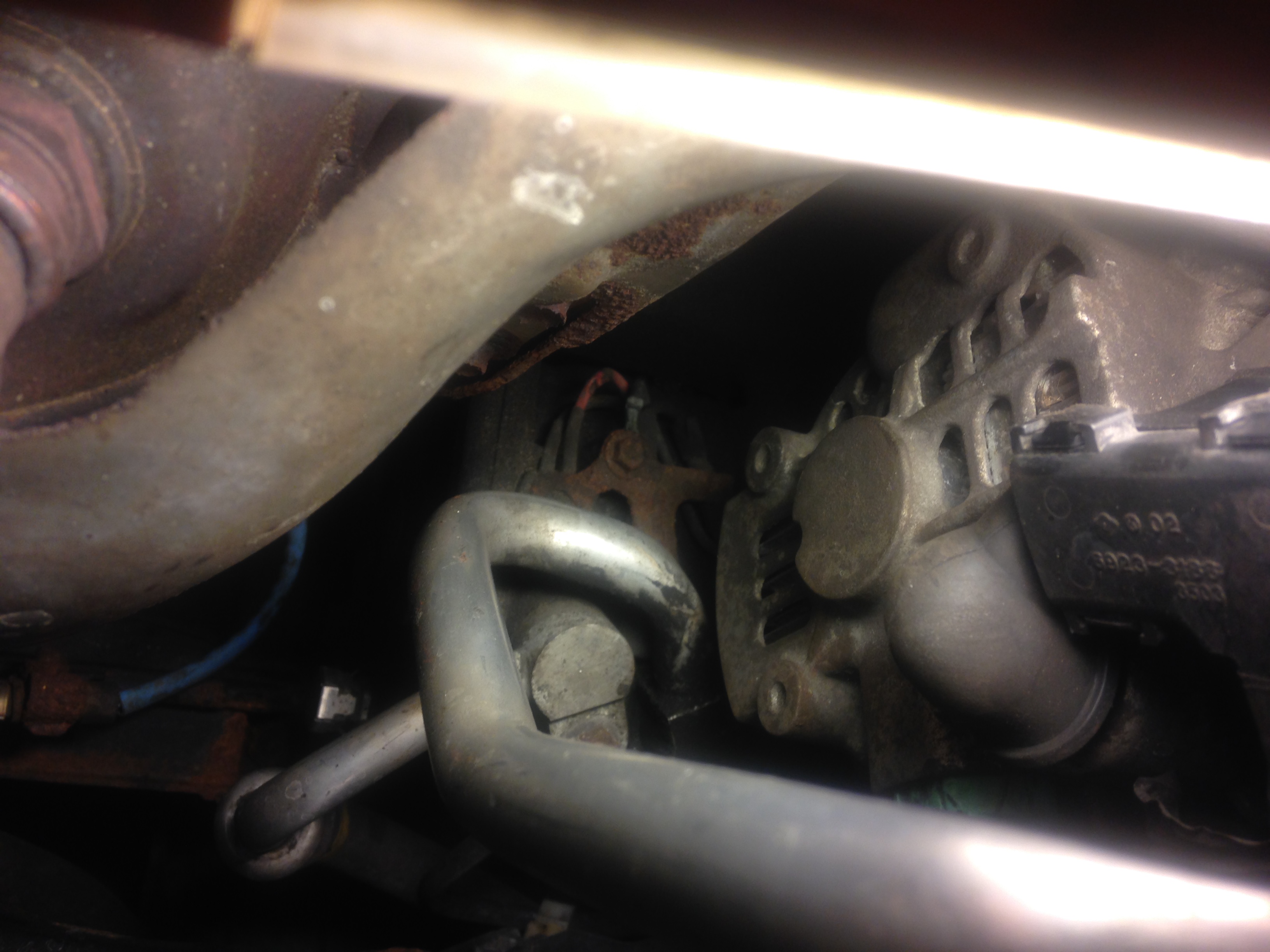

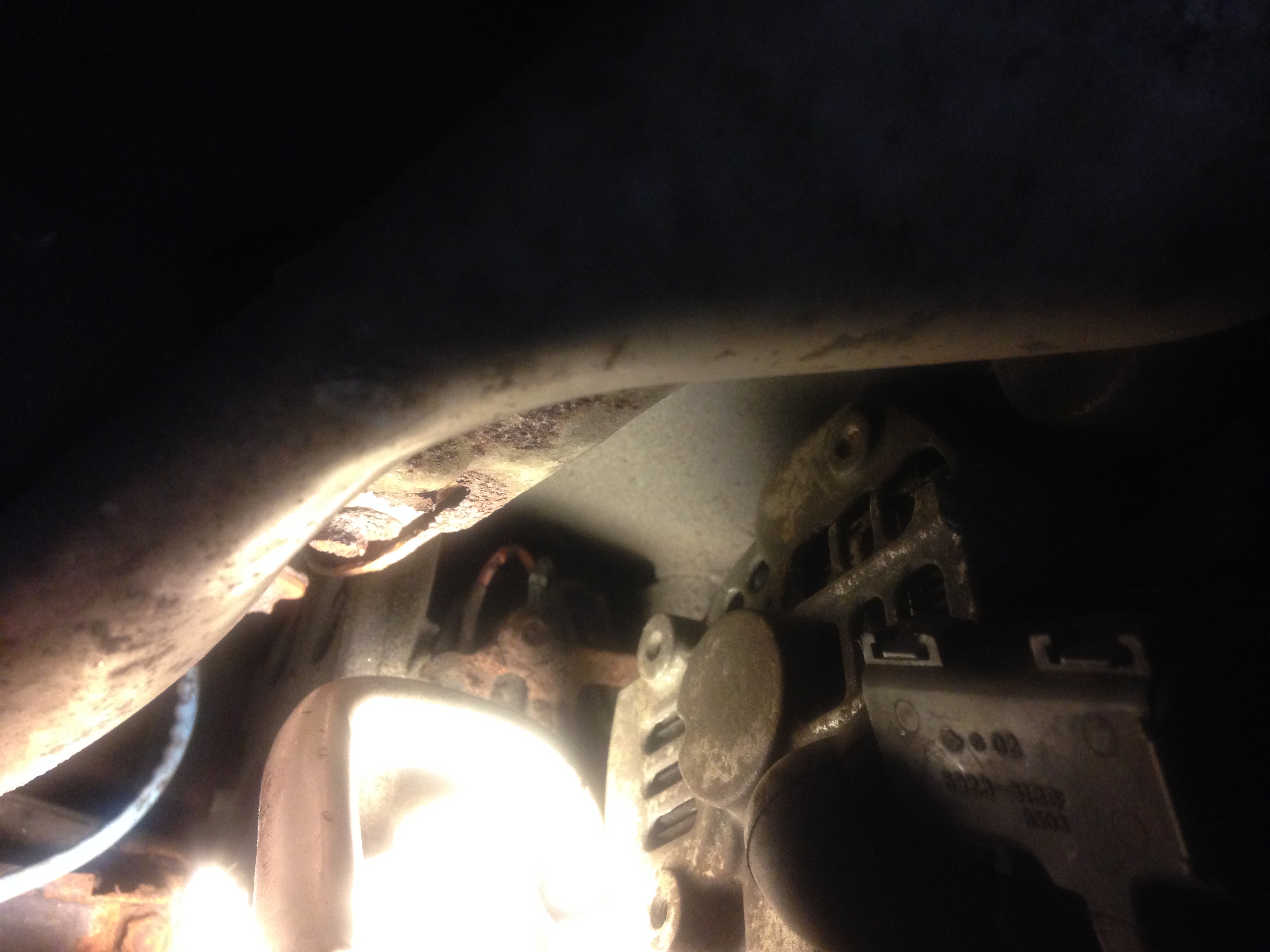

i think i isolated to the 4 wires on the top of compressor.. i can see one has litle tear in it.. anyone has diagram of this... i hate to tear my power steering pump and alternator to just find out..
i would like to check power here .... kinda tight.. so i want to make sure ... I also if i disconnect the connector to it to the thermal protector on top of comrpessor.. i can do continuity test.. is that btwenn the two wires in the connector or each to ground...

problem is down at compressor... thermoprotector has one wire at the pic kinda riped..
or i might think is the field coil..

http://www.ebay.com/itm/Genuine-OEM-...VWS8xt&vxp=mtr..
this is what i think.. any way to test this thru that plug.. part number would be nice to verify this is the one..

ok i saw two relays with snowflake sign.. which one is for the clutch in the fusebox?
I assume i need to plug the connector back? it took me 40 min to get it apart ) you realize that..
i rather remeasure resistance at the plug tomorrow to verify.. first .. before i plug it back
Old Apr 15, 2016
Re: 2005 honda civic dx ac compressor
Googled
#2 relay

I still have a broken wire to isolate on it on the compressor , well stripped from old age cracked whatever look at picture

I did look at the pics, I couldn't tell what exactly I was supposed to see though. Which wire is the problem?

It's not a big relay it's a small relay look at the numbers in the fusebox diagram
NOT the colored part

Assuming you locate the correct relay.....and remove it
Diagram of relay
Jumper slots in the fusebox for pins #3 and 5 clutch should click on (I assume it will not click?)
One of those slots (3 OR 5) should have 12v+ all the time
the other (5 OR 3) goes to the clutch field coil. Ohm test between this slot and a good ground (batt neg post)
**** .. ok i didnt short anything else out.. i just started the car...
i dont have numbers in it.. there is two relays signs only.. that diagram is wrong..
one snowflake an contacts, the other snowflake and radiator fan...
better make sure before i send power somewhere i dont need to .. i just did that with the big one.. u had the diagram above.. i didnt cause damage
Compressor clutch relay is still #2 in the diagram I posted
Diagram of relay
Coil should be around 3-4 ish ohms
ohm test , confused here.. one 5 or 3 to battery negative post ... i should have 3-4 ohm?
Meter neg (black) lead to battery neg post
Meter pos (red) lead.... in your hand
First set voltmeter on volts, see which terminal has 12v+ in it. (#3 OR 5 in the relay picture)
The other terminal goes to clutch. Set meter on ohms to test that terminal.
