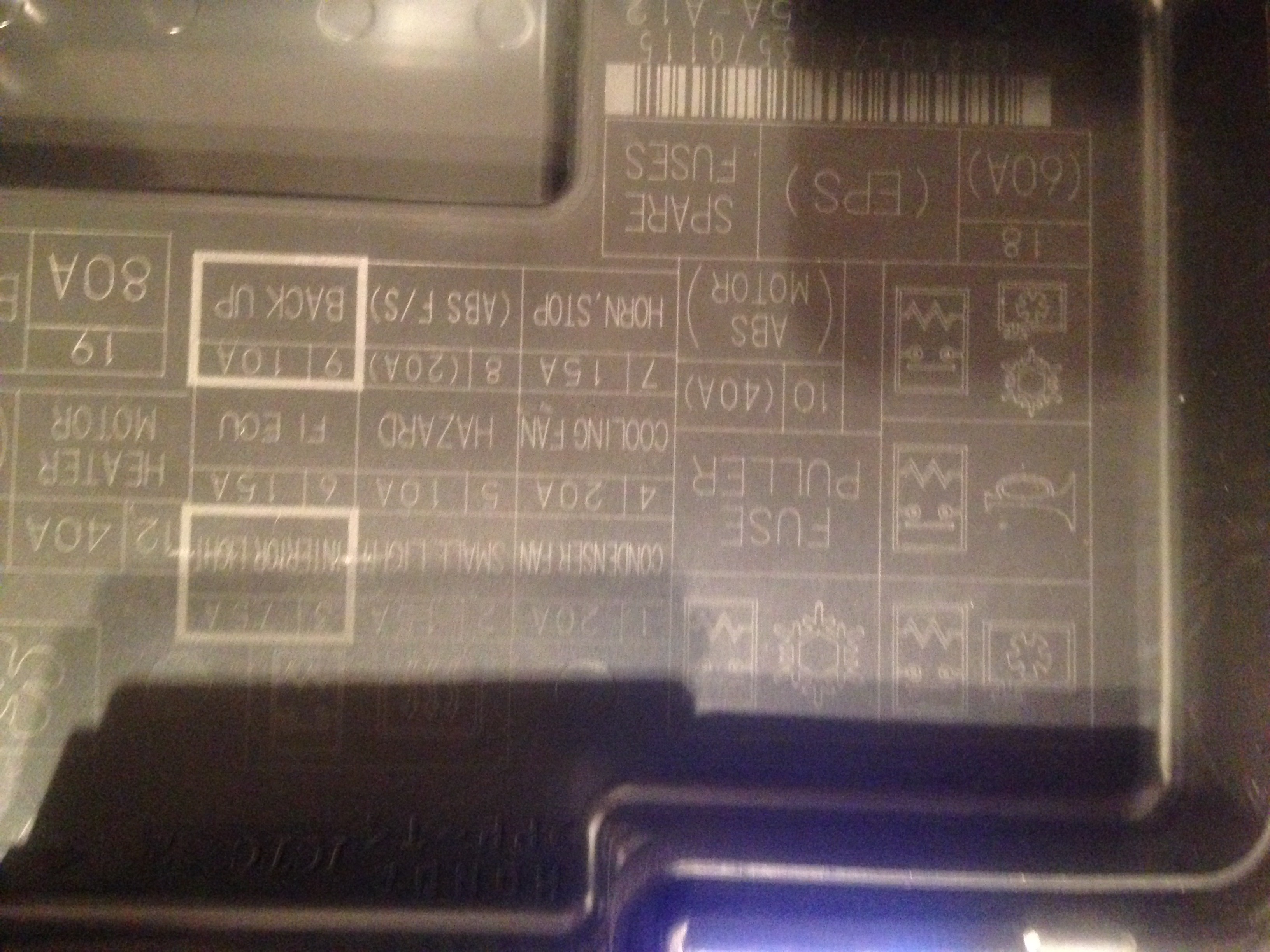

i looked at the snowflake sign it was number 2.. look at the pic i send.. two snowflake.. two relays one on the bottoma has snoflake and radiator fan.. so i swapped both.. i might have put it back ..

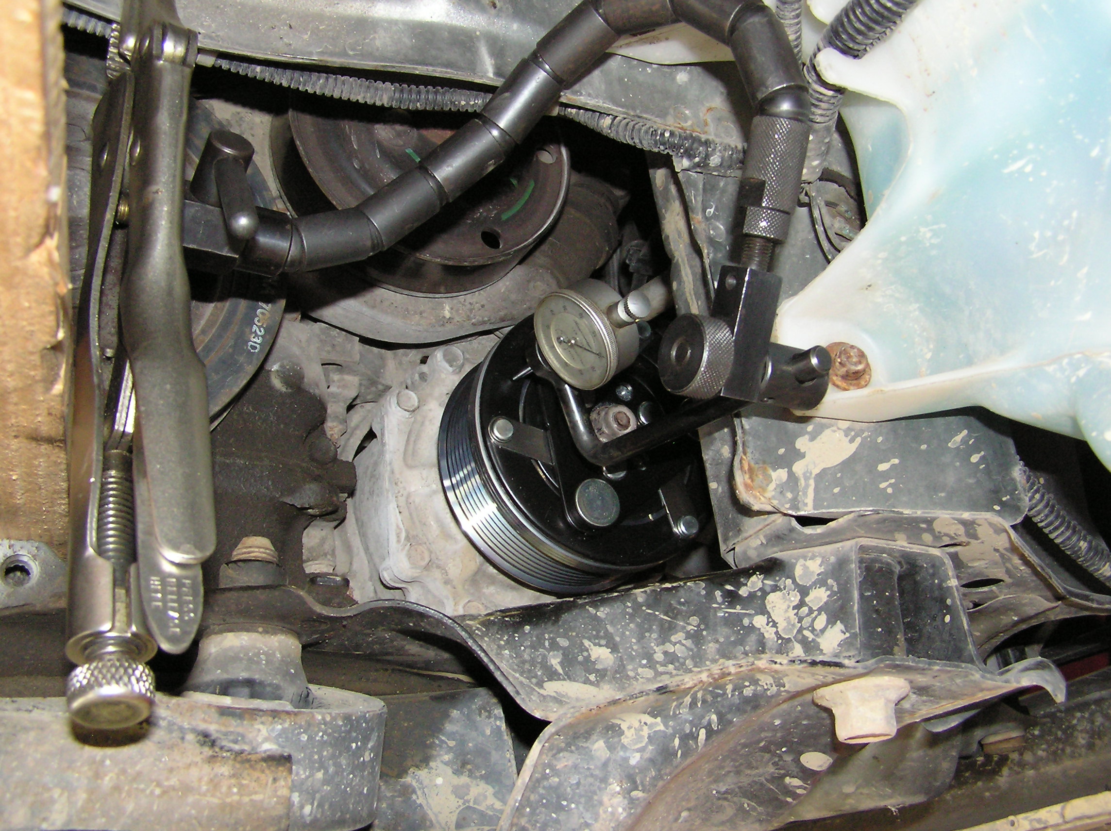

To actually measure gap, I use a dial indicator....because a used clutch and pulley are not flat and a feeler gauge becomes inaccurate.

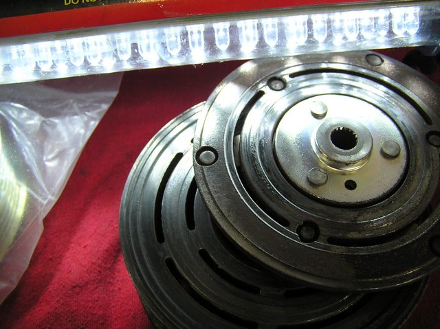

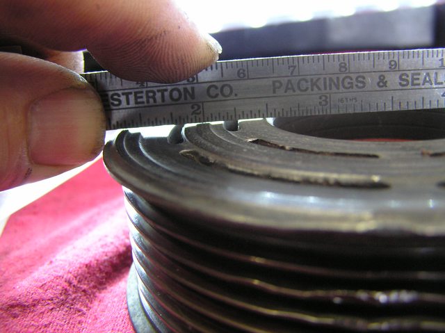

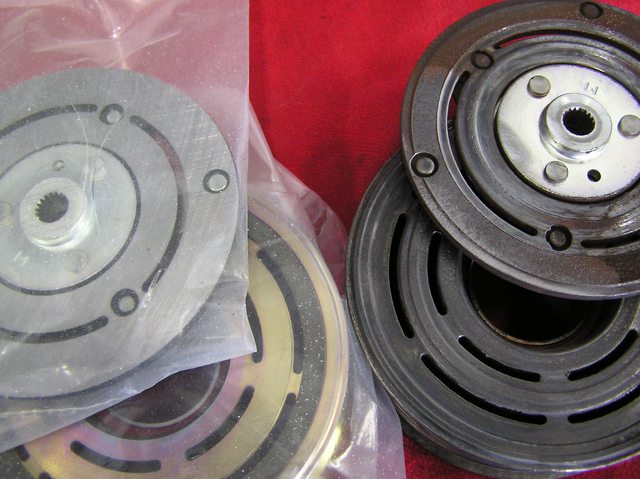

Why feelers are inaccurate when attempting to measure USED parts, worn surfaces are not flat:

If you can spin the outer plate by hand, then it is not engaged nor pulled in.
When the electromagnet is energized it pulls on the outer plate, which should then be pulled tight against the belt driven pulley. That's the loud click when the compressor engages.. If it is pulled tight against the pulley, it should be coupled with the belt driven pulley.
Either there is far too much air gap or the electromagnet is not working (or weak)
Power it up (assuming the clutch does not click on) and see if a screwdriver is attracted to it?
Originally Posted by dsm482
now there use to be atool if i remember to adjust this, goes on the shaft u rent it at autozone.. like this video
should i adjust like this with this tool to get it close.. does that work on my compressor.
No special tools for this one. Adjustment is done using little thin round shims between the clutch hub and compressor shaft.
Remove shim(s) to decrease clearance as needed.
