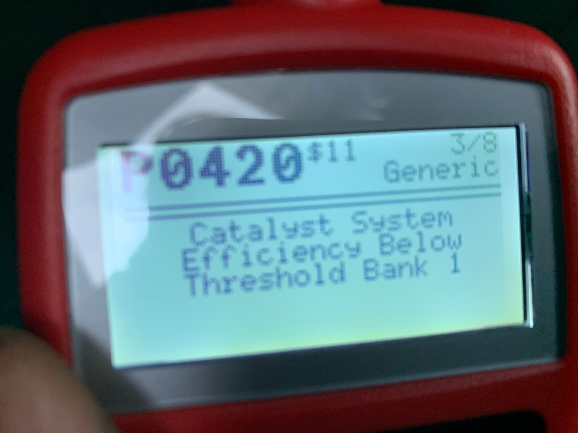

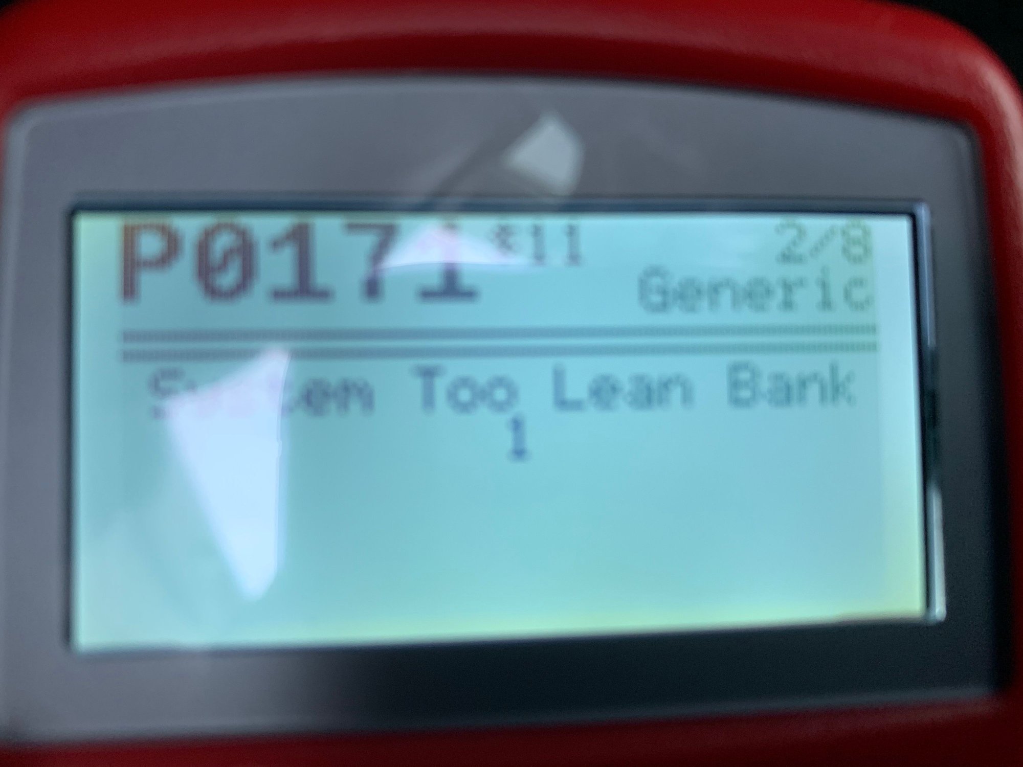

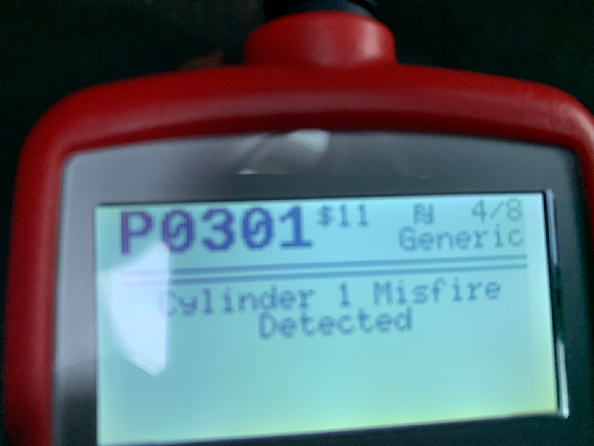

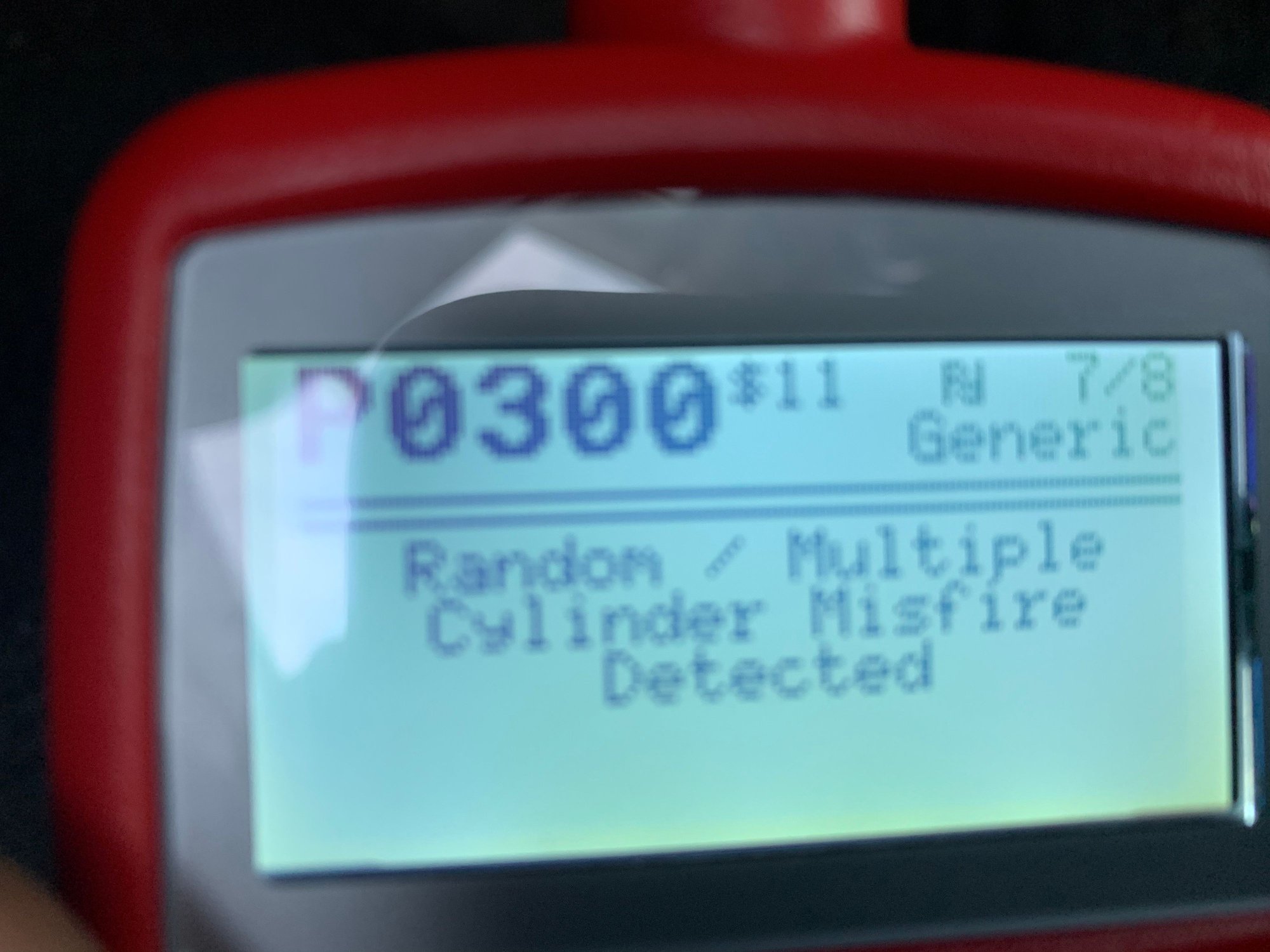

Ok I did what you suggested. Still same. I did get a code scanner and the images are what the faults are suggestions please.
also cylinder 2&4 misfire
thanks in advance
