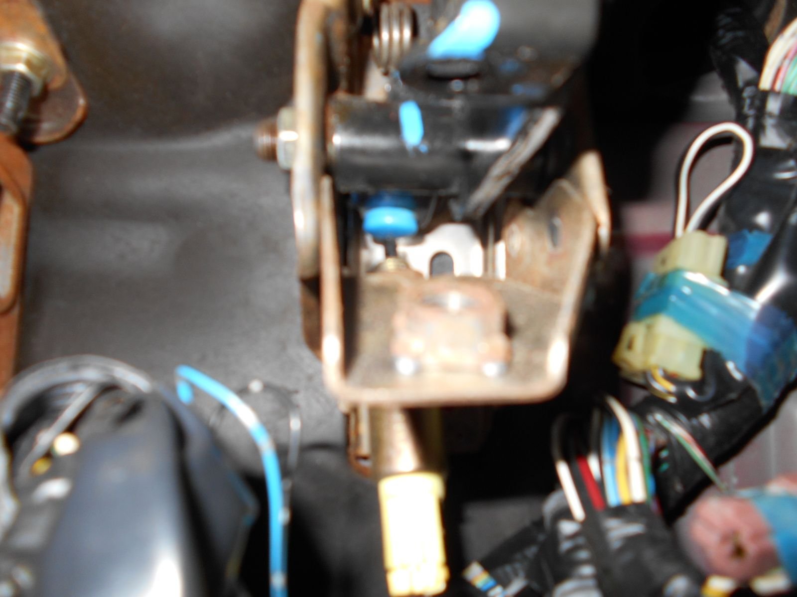

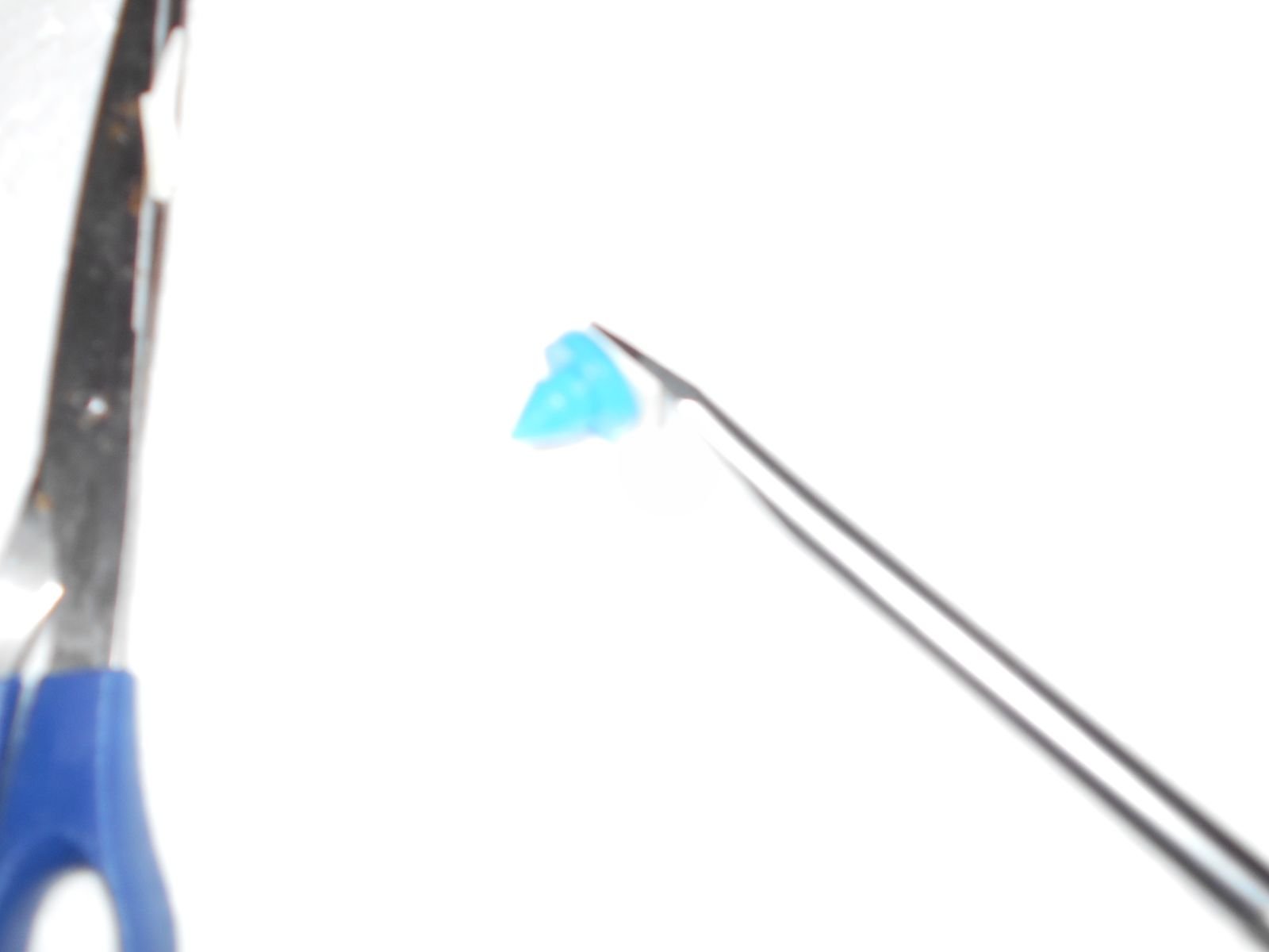

Bet ya'll a dollar they are looking at the brake light switch,the cruise switch ,but not the important switch way way up high inside the clutch pedal cavity.You cant see it unless the top of your forehead is pressing in the clutch pedal while you hold a flashlight in pain.

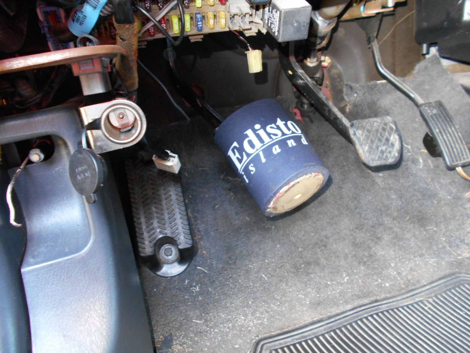

Put a koozie on your pedal and try it.Take your seat out for best results because you must be on your back with your head looking up into it.TIGHT!!!
