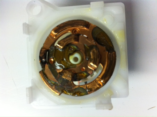

does anyone think this ignition switch looks bad??
ID:	81657   Click image for larger version

I have found my problem... Ignition switch didin't look that bad to me, so i pulled off the top timing cover and found that the timing belt was scraped down to about a 1/4" wide.
Looks like the tensioner came loose and was out too far wich was allowing the belt to rub against the cover and had been slowly rubbing it away to nothing.
However, what was left was still pretty tight so i have yet to determine if it has actually jumped a couple teeth or if all the threads from the worn down belt were just messing with the Crankshaft Position Sensor...
So i'm putting a new timing belt, tensioner and Sensor on when i get home today.
If your guy hasn't found the problem yet get him to check your timing maybe???

Yah it really is a terribly frustrating part to change. I've got it down to a science now but it makes me ill to think about doing it again.
My problem was simple but impossible to figure out until i researched the hell out of it. If you recall there is a strange looking slotted washer that is behind the crankshaft pulley. Well it also only goes on one way and since i had it flipped over (it's slightly concave) the wrong way it made the crank shaft pulley and timing belt sit ever so slightly out of alignment with the other pulleys. Well this caused it to rub and gradually wear down till it was about a quarter of an inch wide, which obviously made it weaker until the engine jumped a few teeth and wouldn't run anymore.
Side story is that i couldn't figure this out for a long time. 2 days of taking it apart and putting it back together, just to start it and hear that it was still rubbing. I think i did it 4 times before i finally found this washer... Nearly in tears from basically going through an panic attack from frustration.
Yours likely isn't worn out but maybe loose. Did you change the tensioner pulley? You really should do the tensioner pulley and water pump while you're in there. It's more money but its a horrific job so you wouldn't want to do it again because of a seized water pump...
I feel for you man. I've been there.
