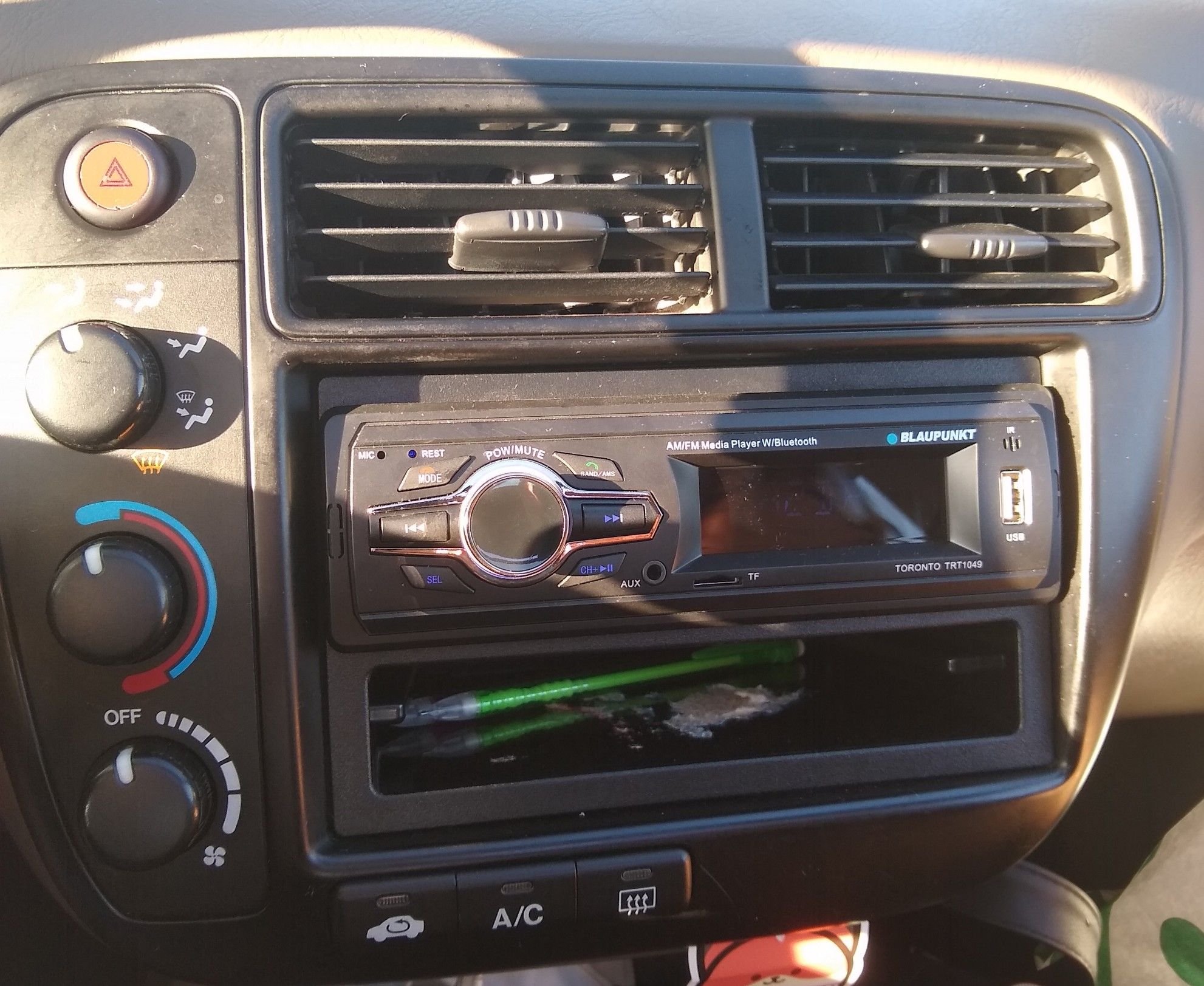

I was wondering how to remove this part. I want to change the bulbs for the climate controls. I don't know what it is called and was wondering if there's like a video tutorial anywhere or if it's just really simple. The picture below is what I want to remove, or at least find a way to change the bulbs for the climate controls

purely speculating here, but if it's anything like my 2002 was, you have to remove the entire bezel assembly like you're replacing the head unit. From there, ignore the radio removal part and you may or may not have to remove the climate control part (literally like 3 or 4 screws if I had to guess) from the bezel assembly to reach the bulbs. Same quarter turn stuff as the gauge cluster
edit: found this link for a 99-00 civic radio removal. They instruct you to remove the climate control stuff to gain access to radio removal. You can ignore the radio removal bits
http://www.installerworld.com/Instructions/99HCR.htm
