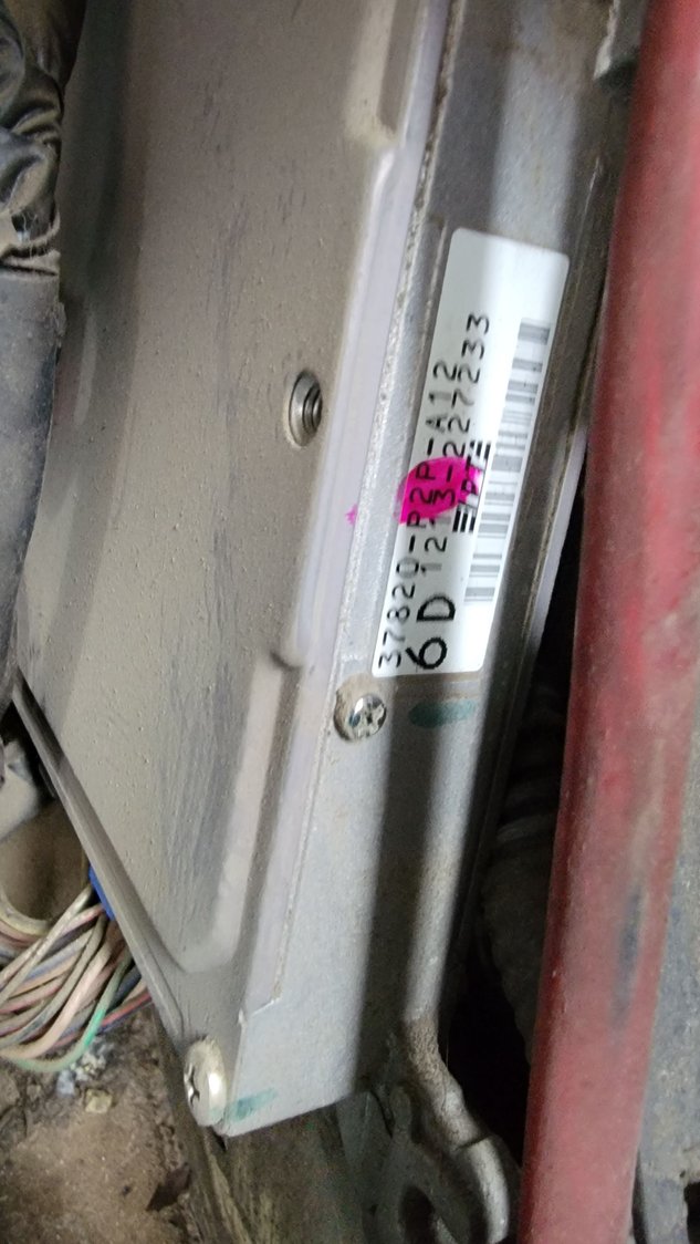

Is this the number I need off the ecu and how to i know if it's vtec or not?

solve the knock sensor first
