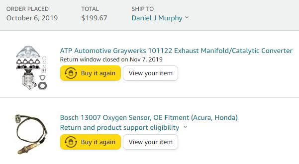

Late 2019 I replaced the exhaust manifold & upstream O2 sensor. (pictures of parts attached)

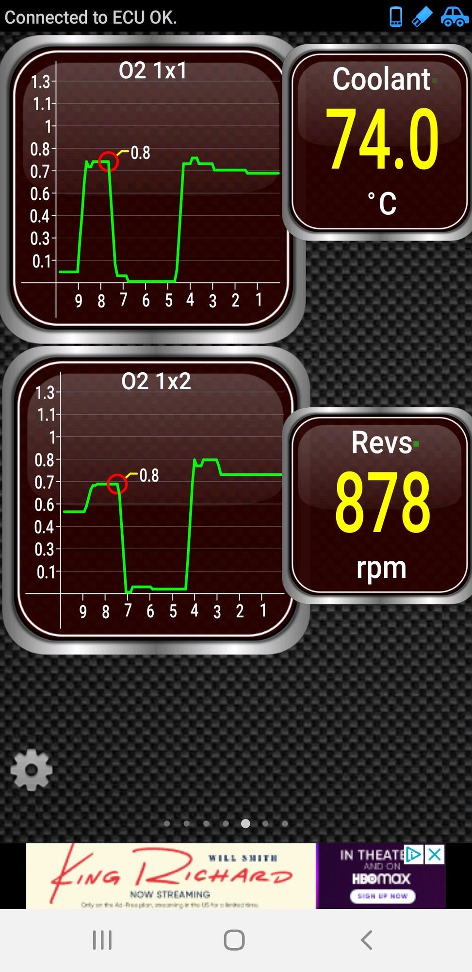

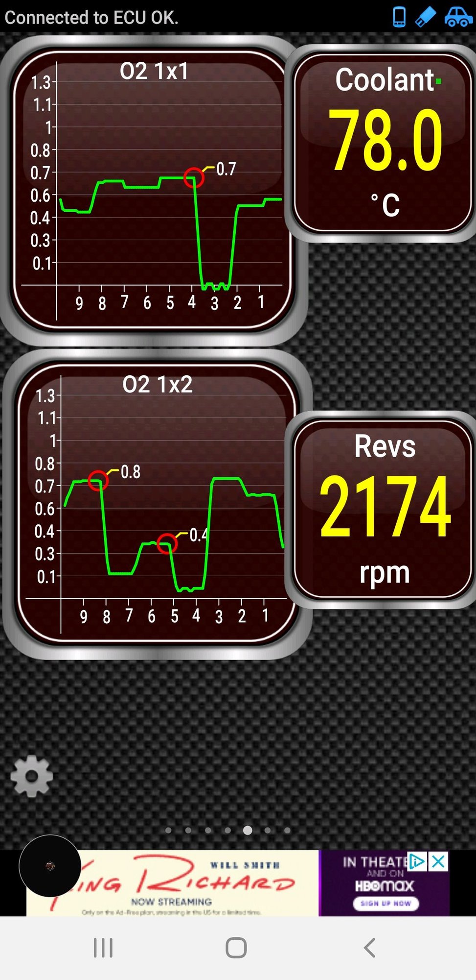

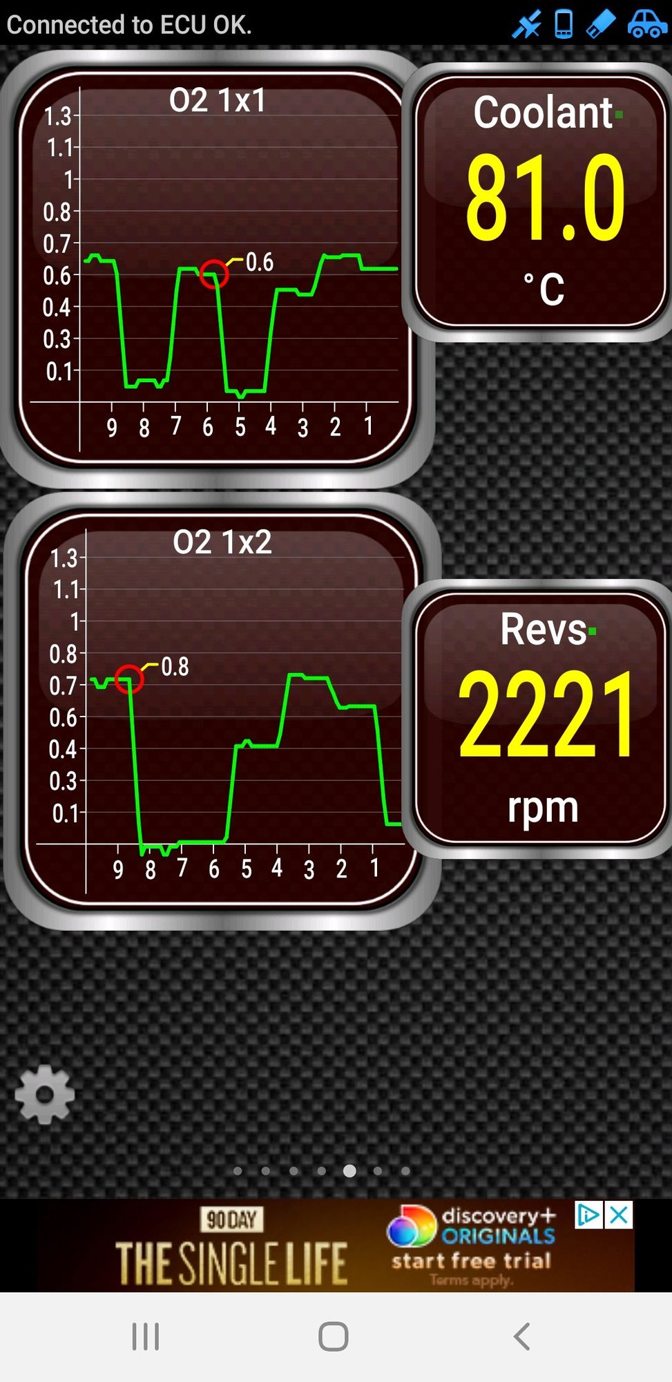

Hooked up my ODB sensor & drove it a bit. Upstream O2 seems to be within spec but the downstream appears not to be. It's supposed to be around 0.5 volts & pretty consistent but mine fluctuates.

Is that the lambda reading for the O2 on those graphs? 0.7 lambda would be like 10:1 AF ratio. That's really rich, and that's the highest reading on the graph.
Edit: After a quick Google search 0.8-0.9V is normal, 0.5V and less is running lean. Assuming you were lifting off the accelerator where the graph dips that doesn't look like a problem.
No, that should be volts. Upstream should be 0-1V & downstream should be relatively constant 0.5V from my understanding.
Had to edit my previous post. Forgot these don't have wideband O2 sensors.
I would be amazed if this has anything to do with the cat, it shouldn't affect starting only when cold. IAT, ECT, and MAP would all affect cold starts.

Bosch is the wrong sensor, needs to be Denso/ntk
