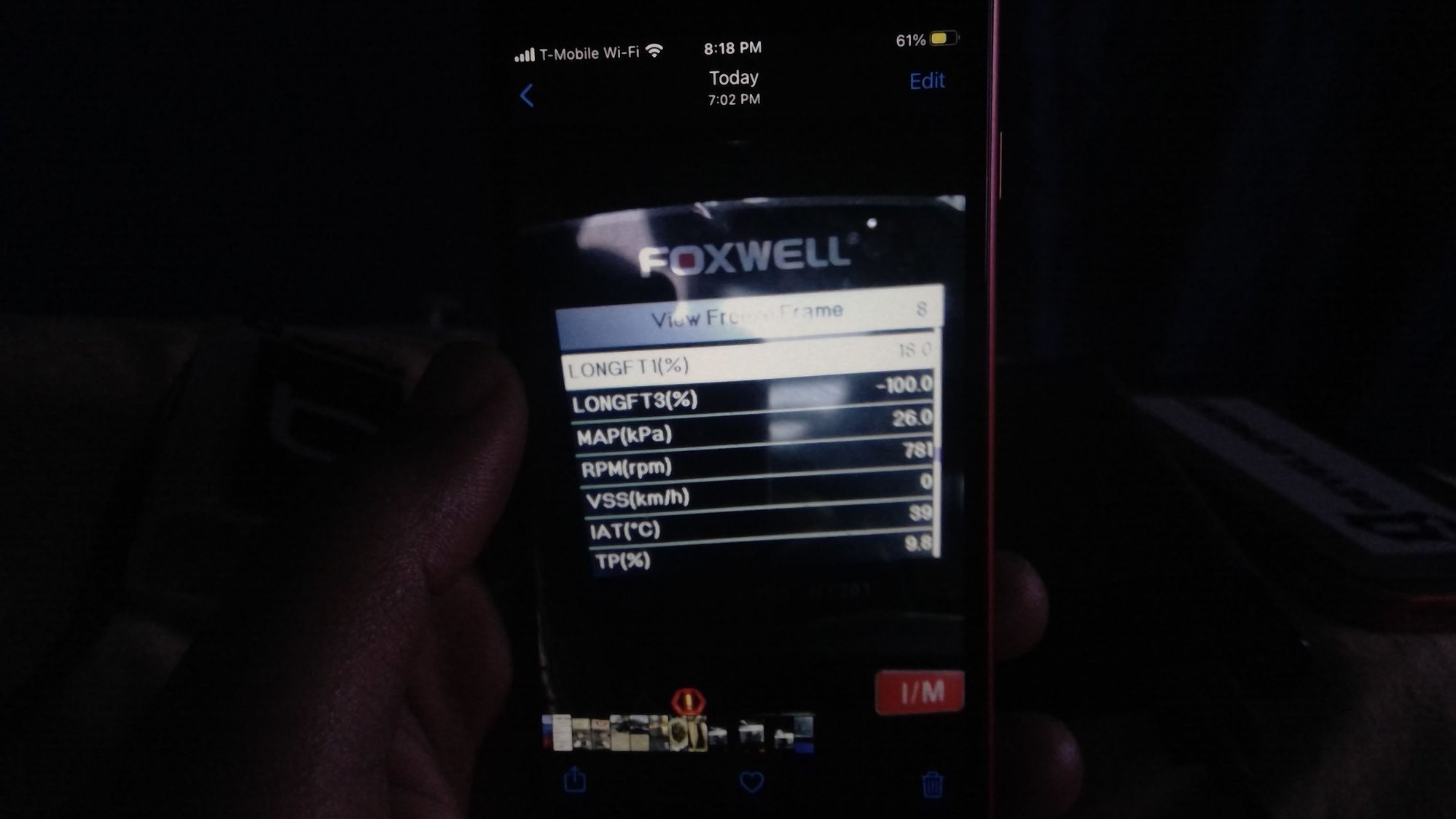

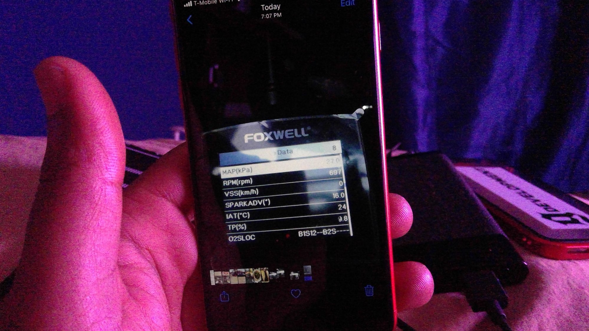

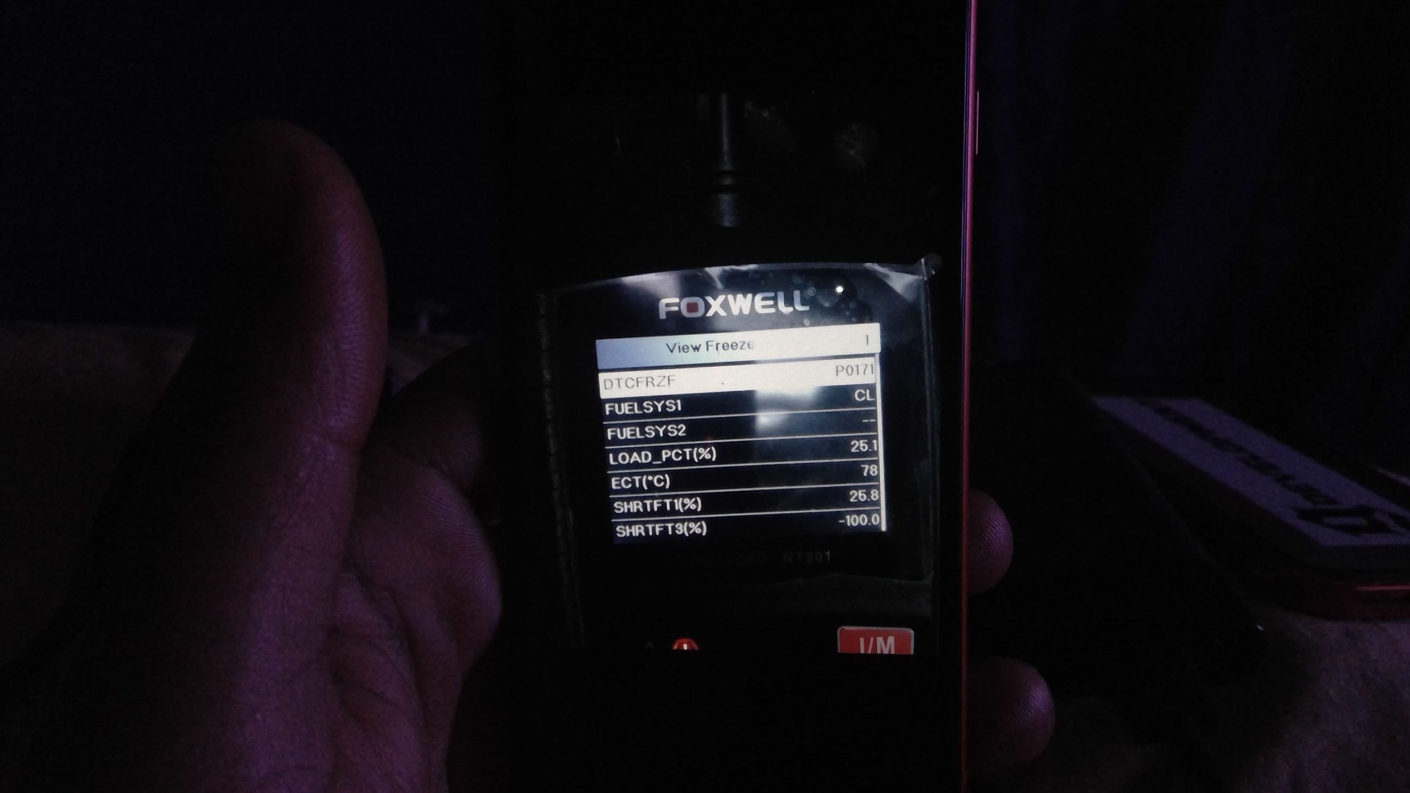

Exclamation CEL on CODE P0171 2000 em1
Can anyone help or any suggestion i am having code P0171 come up with my si, installed new injectors full tune up and new oxygen sensor i have freeze frame data if anyone is good with that stuff,i am wondering if my stock 20yr fuel pump might be on the way out, car drives fine with and without the light on no difference in idle
this was all at idle pretty much

Long term fuel trim of 18%, short term shows 25%. It's adding a bunch of fuel because the sensor is saying it's lean. Does the exhaust smell like it's running really rich?
not at all drives and smells fine minus a little black smoke very little,and the thing is once the car is been driving for a few hours the light would not come on it usually does within the first 30 min of driving
