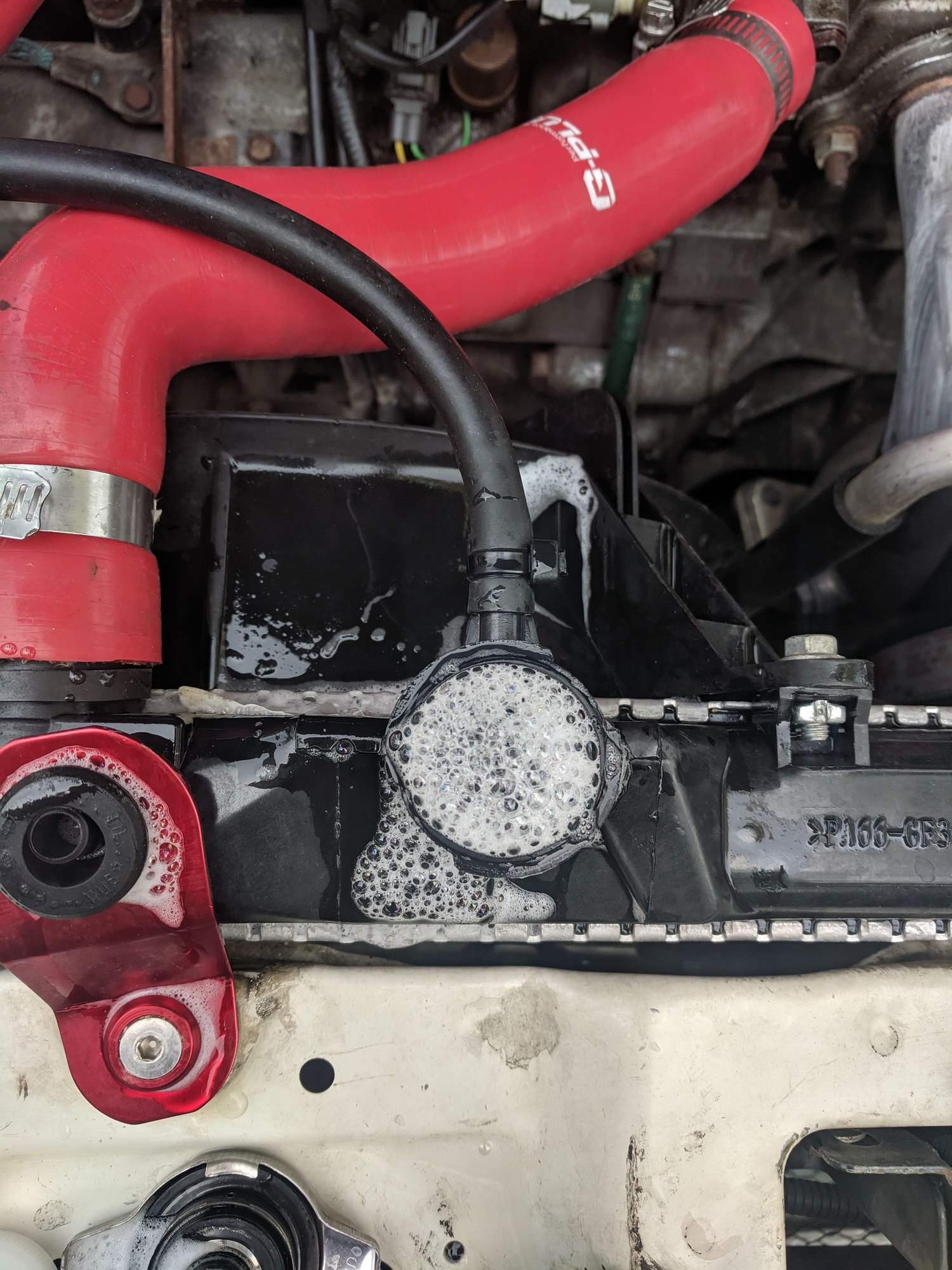

When running the engine foam builds up. I don't know if its from the cleaner that was in there or a leaking headgasket.
No bubbles when I fill the cylinder up with air. The cylinder in the picture that has the air line in it was the one that had the lowest compression at only 160 while the others were at 180.
I used a coolant leak tester and pumped it up to 20 PSI and it held for 10 minutes.
