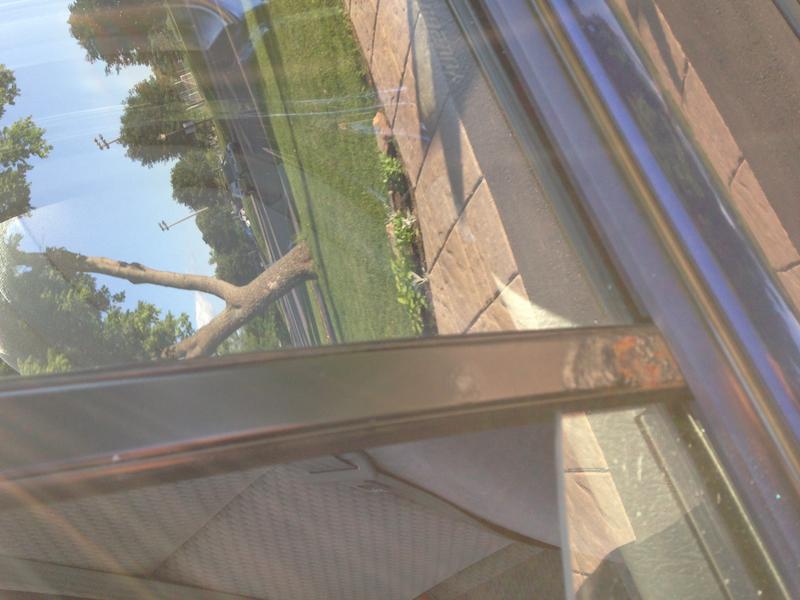

I have some rust on the back window there's the window that doesn't roll down and the one that does. There's a metal panel in the back and it's starting to rust is there a replacement panel or do I need to sand it putty it and sand and than paint it?

And also rust in between the bumper and the quarter panel the usual spot how would you go about that to do this?

Best way to beat rust-replace the part. If you can't do that because it's cost prohibitive, remove parts until you can see and access the entire rust patch. Then Sand it all off, use a rust to metal converter, prime with anti rust primer, and paint. Even then it might come back. If it's bad enough to use bondo on, I wouldn't even bother treating it but I hate body filler.

Is there even a place that they have the part for the rear window? If so send me a link please

Need more information on your car to find the part for you.
This is for an 05 4 door DX:
http://www.hondapartscheap.com/parts...ding-protector
Only place you will find this is at a junkyard or the dealer (local or the website I posted). You can try ebay but i highly doubt you will be able to find it.

It's not even there it's a small moulding in the back window you have one molding in between the front door and the back door those are the big moldings I need the other one in between the rear window that cranks down and the other rear window that doesn't crank down ill take a better pic tomorrow but ill upload another one that I took

2005 civic special edition it's hard to explain it maybe a should take a pic and circle what I need to change

Go to a junkyard and show them what you need. I'm pretty sure they'll be able to find you one.
