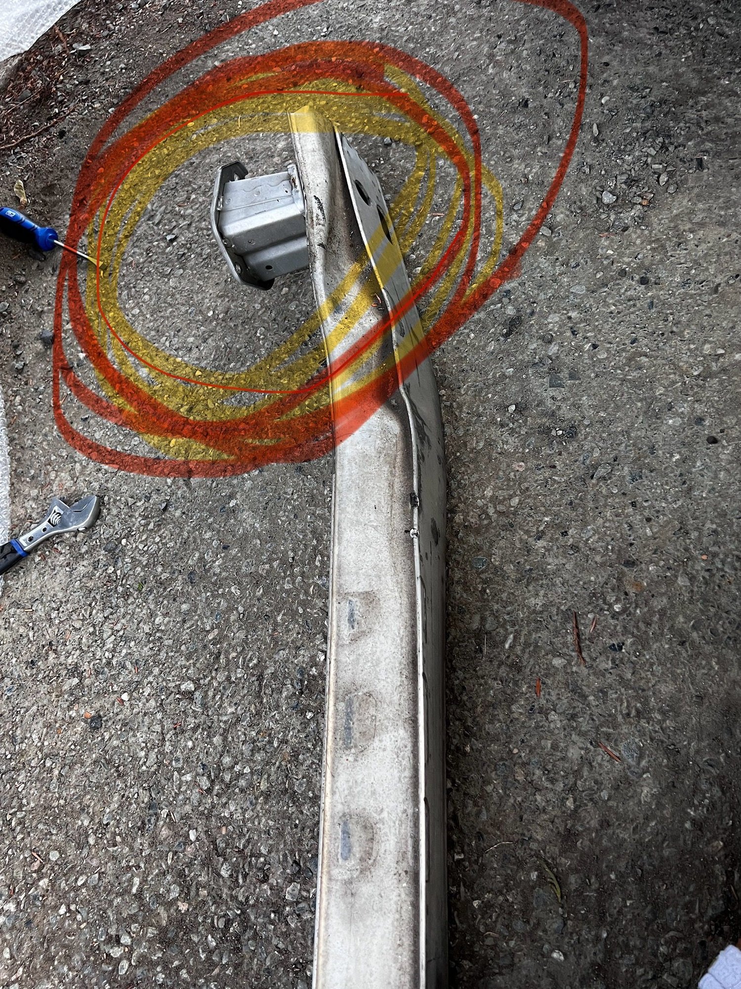

I was replacing the bumper cover on her 2006 Honda Civic and discovered it had been in an accident at some point. So I’m replacing the metal Bumper reinforcment bar. I need to know the name of the two metal blocks attached to it which you use to attach to the rest of the body. I’ve circled the part in the picture. Anyone know the name of that part? When I’m looking for the part I can’t figure out what to call it.

Go to an OEM parts store and use the diagrams to help get a name and part number.

Bumper extensions. Part number 71535-SNA-A00ZZ and 71585-SNA-A00ZZ (right/left).
