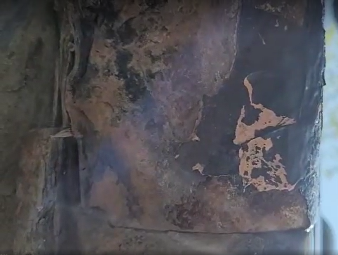

After sanding it down, using drill driver with a wire brush, still there are black spots. Do I need to remove these black spots also and get into metal or no? Sharing the pic. Thank you.

This is where the rust converter comes in. It'll help with that. Apply it like paint. 1-2 coats is fine. Then bondo, prime, paint.

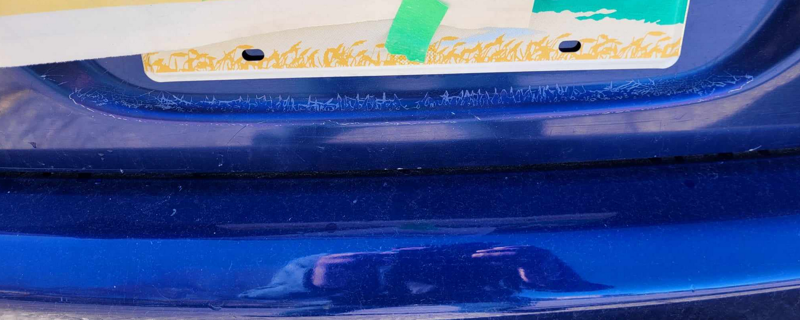

Hi.
1. I have clear coat peeling off. If I use 800 grit sand paper on the clear coat (saw on youtube videos), wont it damage the color (or base coat)?
2. Also How far from the peeling coat should I sand?
3. Do I sand on exposed base coat or avoid sanding it and only sand clear coat?
Thank you.

Sand the entire affected area, as long as you dont sand the base coat too much you'll be fine
