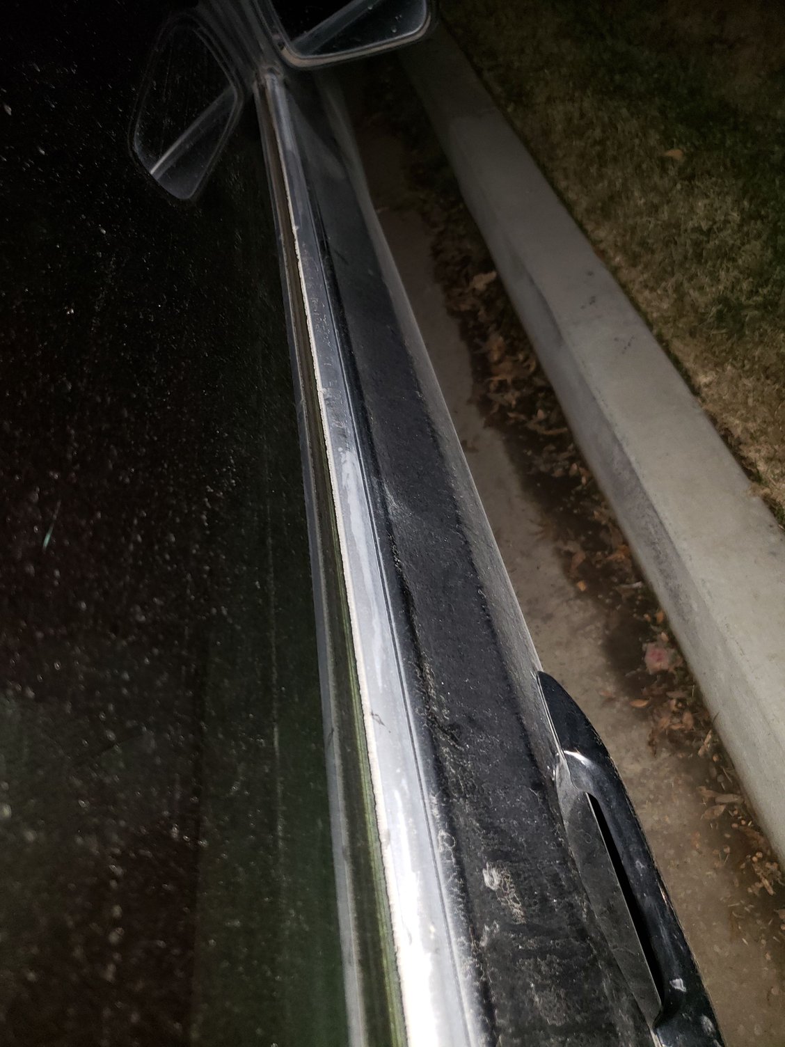

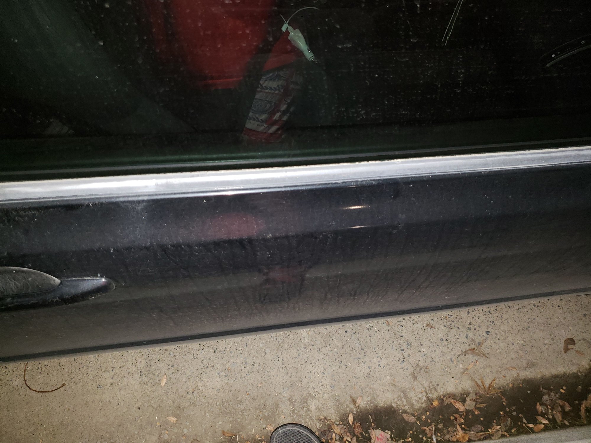

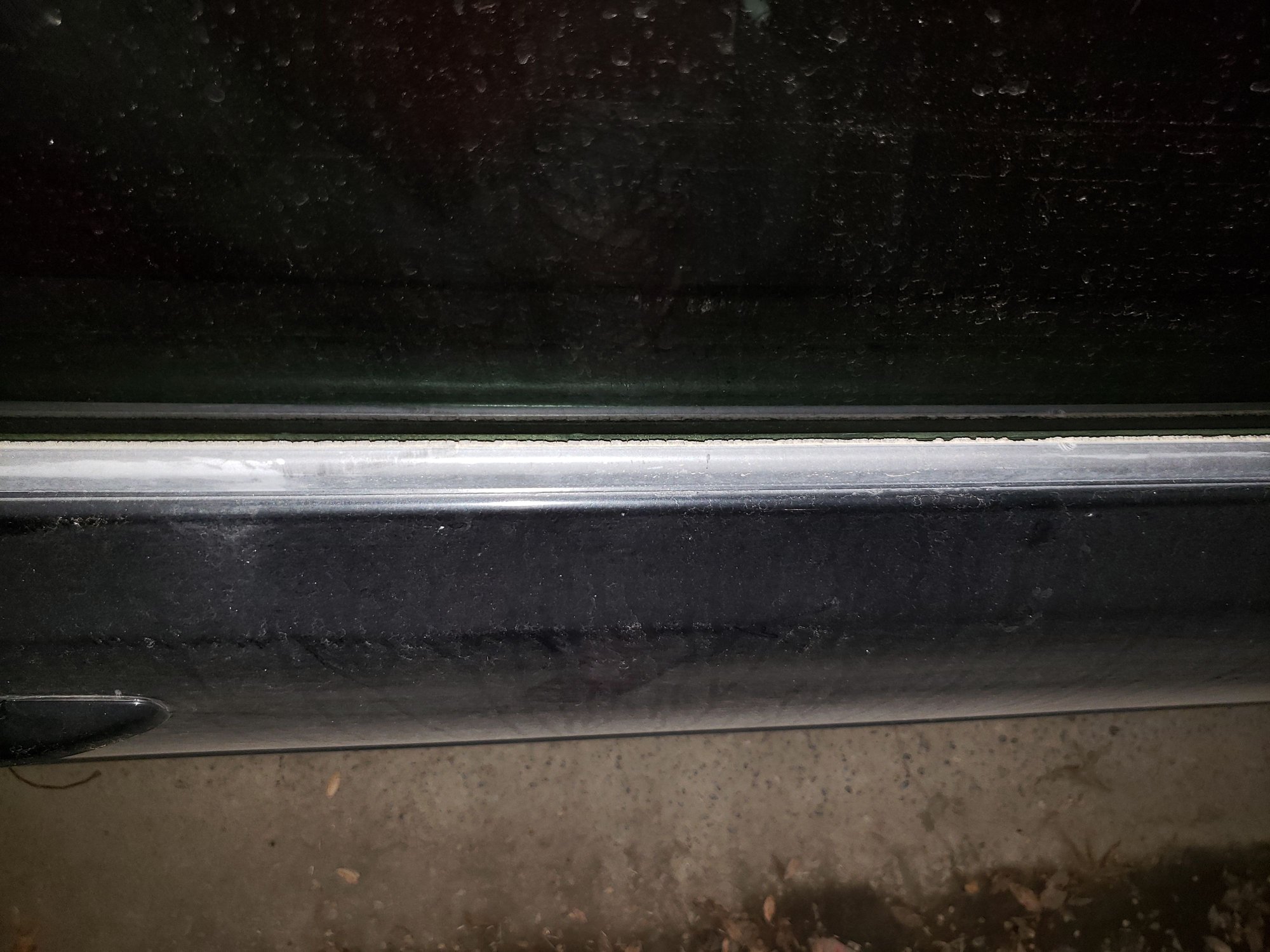

The window down liner on my si came off today, peeled off when raising my window up, would this be a diy thing or should I take it to a shop, and how do I find the right replacement? Any advice is appreciated, thank you. Also, should I be concerned about rain damage, as it is currently raining where I live, thanks again.

The exterior window liner? May need a photo for clarification.
Whether it's DIY or not entirely depends on if you want to DIY it or not. eBay or Honda should have replacements if necessary.
Rain damage is unlikely if it's just a liner, but a photo will help answer.

Oh, just the rubber coating? I'm pretty sure a windshield place could help with that. I probably wouldn't even bother replacing it.

Part numbers are 72410-SVA-A01ZA (passenger) and 72450-SVA-A01ZA (driver) if you want to buy replacements. Only like $40 each but a pain to replace.
